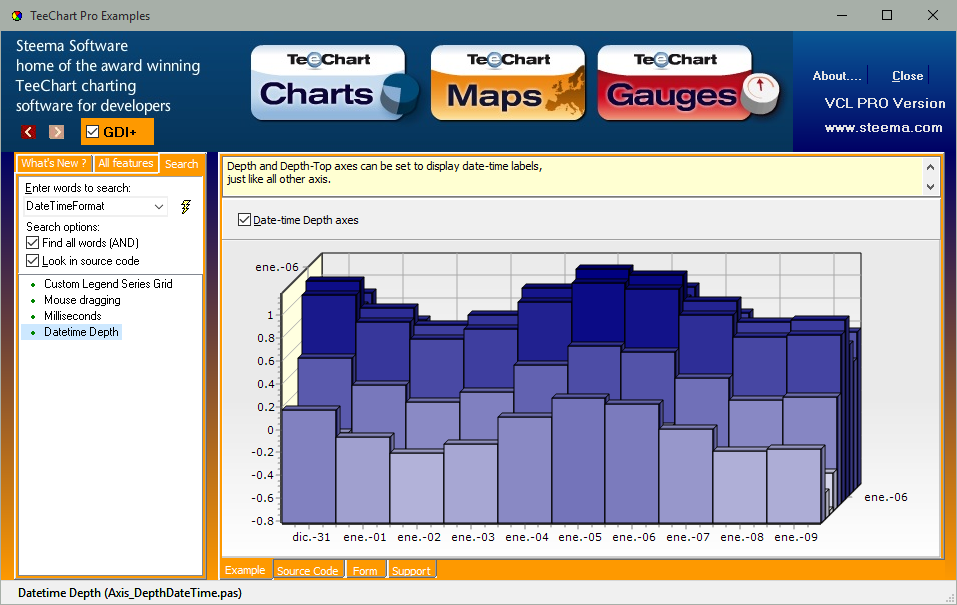

Jeff wrote:The Tee9new.exe demos' search function not work.
If I search for "DateTimeFormat" in the Features Demo I get an AV but it continues and I get 4 results:
