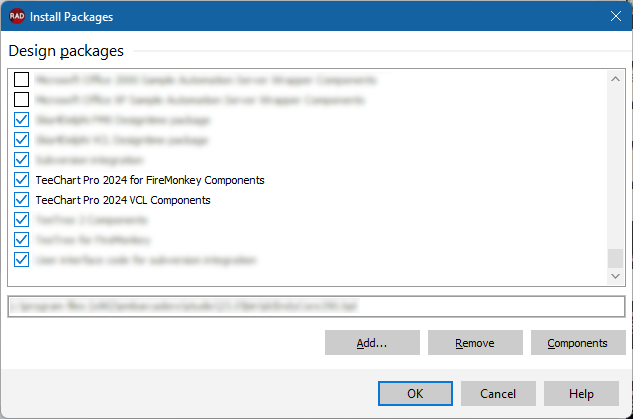

  3. Go to "Component/Install Packages...". In this list, check the TeeChart Pro components are selected and not the Lite/Standard version that were shipped with the IDE.
