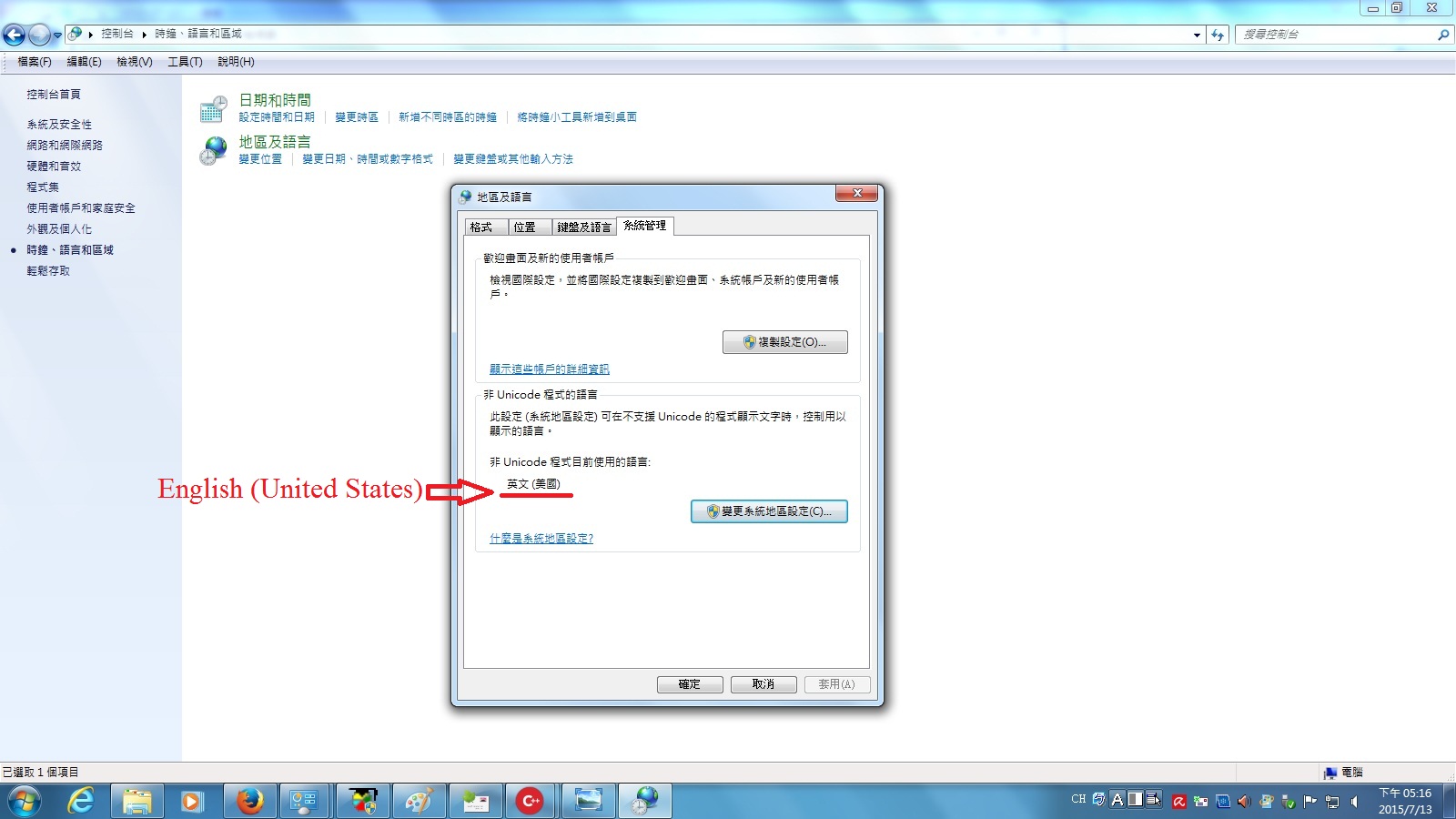

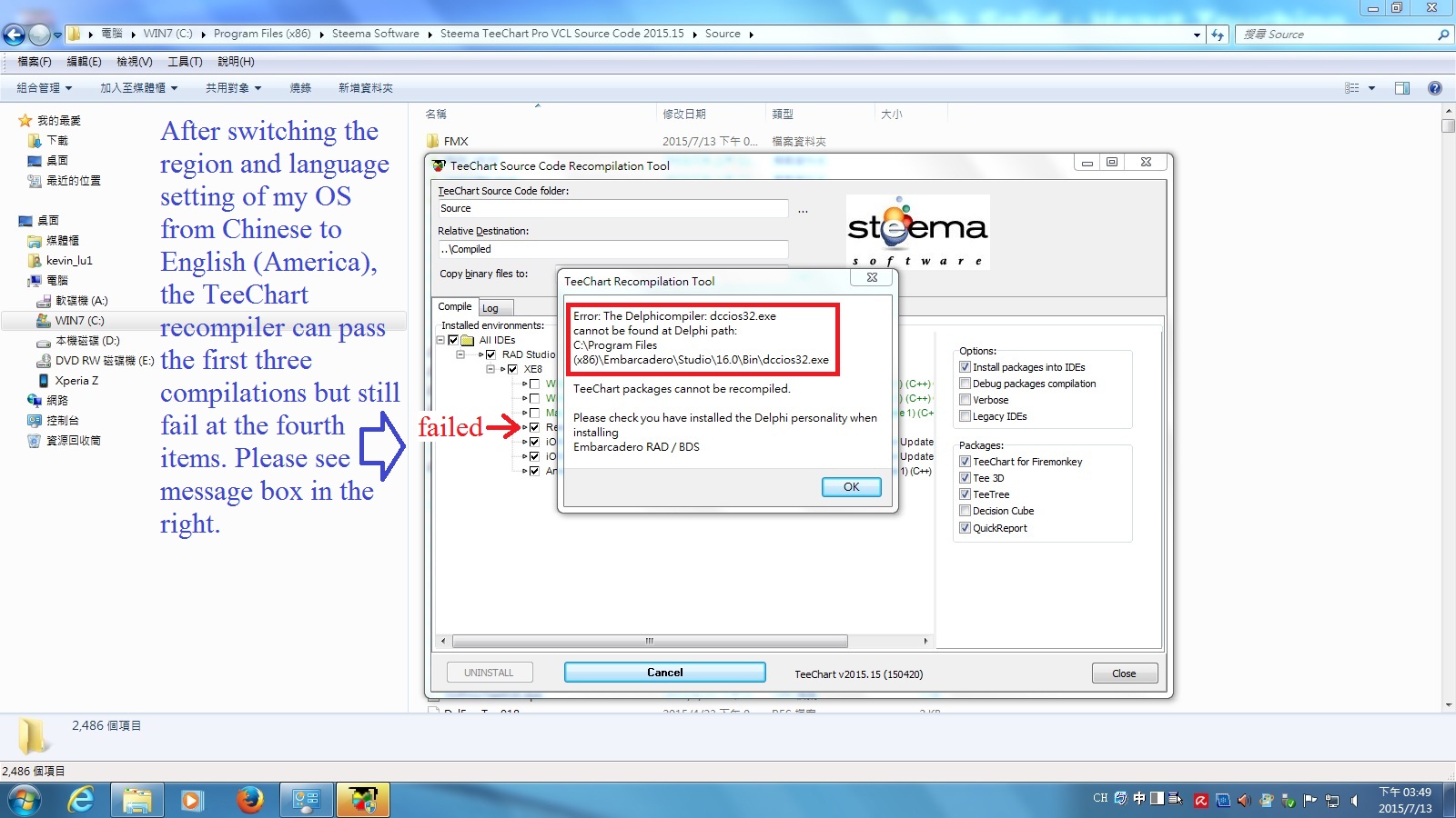

Hello Sandra,
We tried switching the country and language setting of my OS from traditional Chinese to English (United States) but still can’t obtain a successful installation; the re-compiler says it can’t find dccios32.exe in my computer.

Re: help,how to install in delphi xe6
Post by Sandra » Mon Jul 13, 2015 2:15 pm
Hello Drinker,
Thanks for your answer. Please uncheck the options for iOS in the TeeRecompile program and attempt to recompile. That way we can check if there are any other problems.
Assuming that it compiles correctly, please recheck your RAD Studio installation to confirm that the part for iOS is correctly installed. It appears that the required Delphi iOS compilation file is missing.

Post by Drinker » Thu Jul 16, 2015 3:01 am
Hello Sandra,
After unchecking the options for iOS as what you advised, I have finished the TeeChart Pro recompilation & installation at last.
