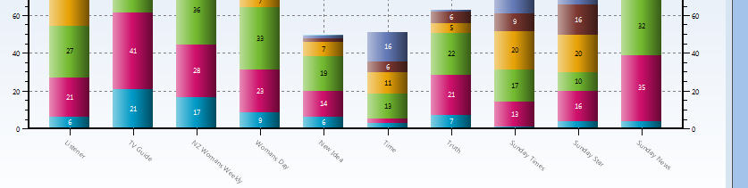

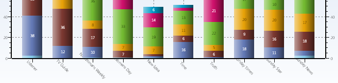

In TChart version 8.02 I rotated bottom axis labels and they looked correct as per attachment. In version 2013 they are not correctly placed as per second attachment. In version 2014, the same problem exists. Can you advise what I need to do to get the desired label placement?
Incorrect Bottom Axis Labels
TChart Ver 2013 Axis Labels Rotated Wrong.PNG (11.23 KiB) Viewed 8714 times
Correct Bottom Axis Labels
TChart Ver 8.02 Axis Labels Rotated Correct.PNG (14.4 KiB) Viewed 8707 times

This is an issue we are already aware of as you can see here:
http://bugs.teechart.net/show_bug.cgi?id=947
