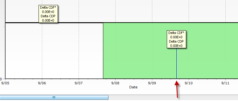

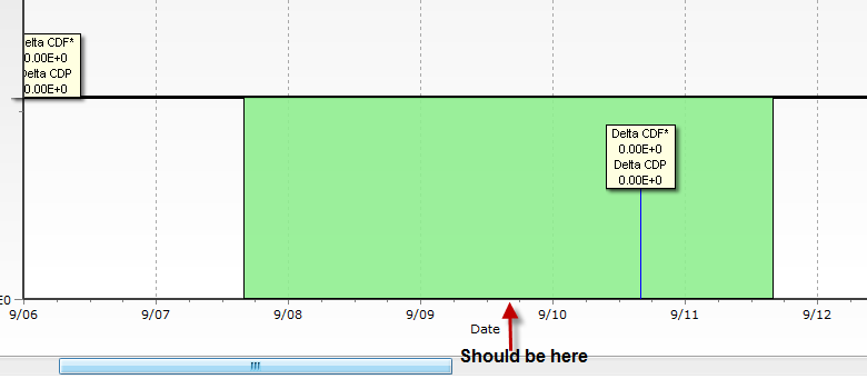

I have added some MarkText to series marks, and all works well unless the user moves the text boxes and also moves the scroll bar.
If the user moves the MarkText and then scrolls, the MarkText stays in the same screen position, and does not move with the rest of the cart. This happens for all unmoved MarkText items after the one moved, but any unmoved ones before it work fine. Once you scroll to where the item would no longer be visible, then it just disappears.
I was using 8.06 but upgraded to version 8.08 and the problem still exists.
See Attached Pictures.
Original Location
Scrollbar Moved
