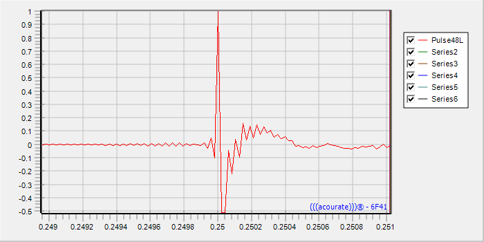

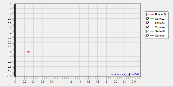

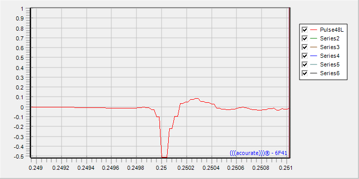

My problem is that the chart must allow zooming. With DrawAllPoints:=false a series is quickly drawn. But then with zoom I get a wrong display.
See an example with not too many points (justabout 65000 points):
First the plot with all points with/without DrawAllPoints:
DrawAllPoints := true;
or
DrawAllPoints := false;
Now with zoom
Obviously the last chart is wrong.

I guess I made a wrong conclusion.
The first picture show the high amplitudes. So the data points are there.
But in the zoomed picture the high amplitudes disappear, despite DrawAllPointsStyle := daMinMax;
So it seems that with DrawAllPoints switched off DrawAllPointsStyle is no longer in use and thus it may be the reason for the missed high amplitude.
- Uli

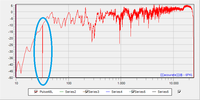

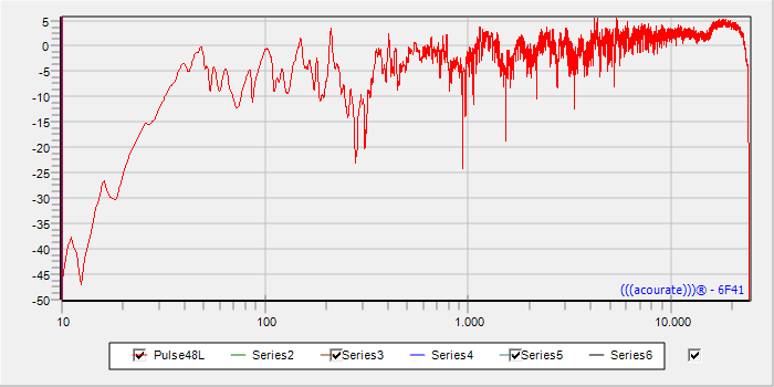

Yesterday I have got a test version of Series.pas by Narcís.
It solves the problem described by the example code but creates another problem.
See an example of a frequency plot with 65537 points.
With DrawAllPoints = false the chart shows artifacts, see marked area
With DrawAllPoints = true the chart looks ok
Uli
PS: please see also the wong legend display. I start another topic about this

Post by Yeray » Tue Jan 27, 2015 10:08 am
The modification Narcís sent you seems to fix the example in the ticket here, isn't it?
If you've noticed it is breaking a different case, please try to arrange a simple example project we can run as-is to reproduce the problematic situation here so we can study it.
