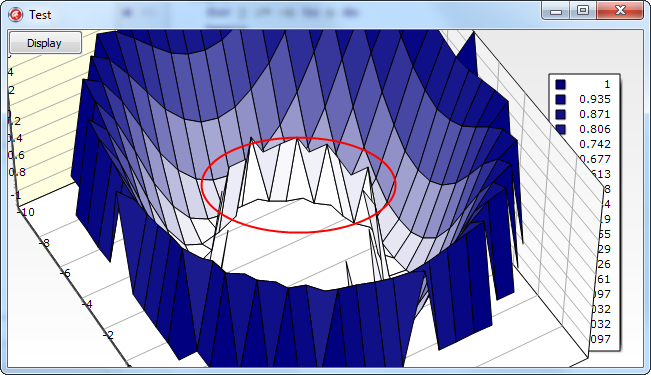

I want to draw a round surface with a hole inside.
The result is not what I expect. There are side effects at the contour.
Is there a way to remove these drawings not very nice and which are not par tof the real surface ?
I joined an example code.

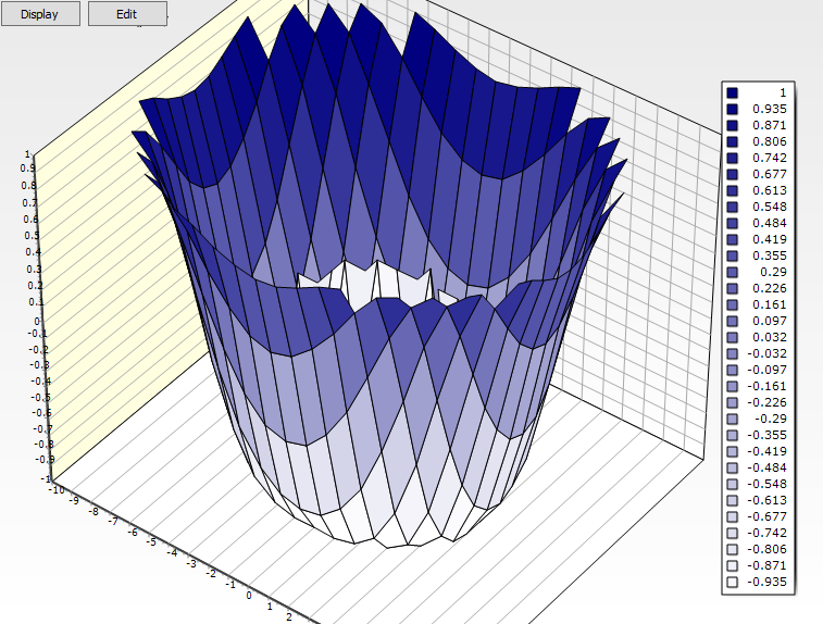

Post by Yeray » Mon Apr 28, 2014 1:49 pm
Hello Nicolas,
I'm not sure if this is what you where looking for but if I comment the last AddXYZ call in your code, I get this:
  n := 10;
  Series1.Clear;
  for i := -n to n do
    for j := -n to n do
      r := sqrt(sqr(i)+sqr(j));
      if (r<=n) then
        if (r>4) then
         Series1.AddXYZ(i, Cos(2*pi*r/n), j);
        end else
         Series1.AddXYZ(i, 0, j, '', clNone);
      end else
//         Series1.AddXYZ(i, 0, j, '', clNone);
If this is not what you where trying to draw, please try to highlight what exact polygons you find to be not expected given the data you've entered.

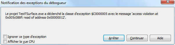

Thank you for your answer, it's what I want to get. I want too that the contour of the hole inside has not this effect.
I tried your correction, but I've got a violation access (I just comment the last AddXYZ line).
Maybe I have a wrong installation because if I don't fill all the points of the series (it means 10x10 points), I have this access violation.
First I've just wanted to add points where the data are valid.
I think it should be possible to fill the series with any number of points. So I don't understand this behavior.
My goal is to draw a surface in which there are holes with any number of points.
Nicolas

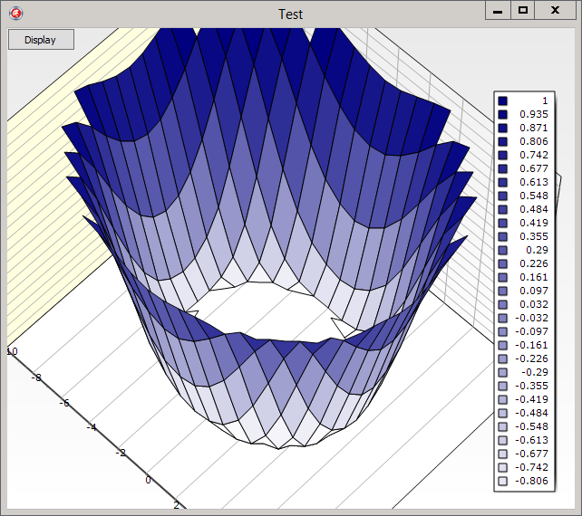

Post by Yeray » Tue Apr 29, 2014 10:38 am
Hi Nicolas,
If I remove another line I get this:
Here is the code I have:
procedure TForm2.BDisplayClick(Sender: TObject);
var i, j : integer;
    n : integer;
    r : double;
  n := 10;
  Series1.Clear;
  for i := -n to n do
    for j := -n to n do
      if (r<=n) then
        if (r>4) then
        end; {else
         Series1.AddXYZ(i, 0, j, '', clNone);}
      end; {else
And here the complete project:
TeeChartTest.zip
(1.95 KiB) Downloaded 340 times
Maybe you are not using the latest TeeChart version, are you?
What IDE are you using?
You could also try setting IrregularGrid to true. See this for more info on how to populate this kind of series.
