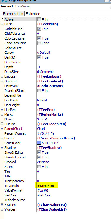

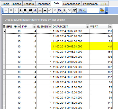

Everything are ok, but in my datas are some Values with "NULL" not "0"!! The Line are interrupted (see Snap4.jpg) correctly, but when i export the Lineseries, the "NULL" value are exportet with "0" (see Snap5.jpg), but i need a "blank" cell!!

Hello Narcis
Thanks for your fast answer, but i think tou didn't understand my question.
Because, i use the NULL Values to prevent to draw the line (see snap4.jpg). Everytime my PLC (Controller) are Offline i add a NULL Value to the cart (see snap5.jpg), to show the user that are no values saved at this time. The Line is drawed interrupted. This is working well, but when i export this values, my NULL Values are exported as a "0" value!! This is my problem! And i also think these are not correct!

Re: Problem Export with TSeriesDataText and NULL Values
All the points in TeeChart have a value, even if they are null. The null property is like a flag (it's actually clNone Color), independent than the value for that point.
This way you can choose to not to draw the null values, as you do, with tnDontPaint, but you can still draw them with tnIgnore, if you want.
The value a null point has depends on ho you've entered the point. If you use the AddNull method, the point entered will have the DefaultNullValue value. If you use SetNull method, the value for that point isn't changed, only the Color.
I can think on two ways to know what points are the null points in your exported file:
- You can to export the series with IncludeColors=true so the colors can be also exported and you can know what values were null points.
- You can set a particular value when adding/setting your null values. A value that you know that can unequivocally identify your null points. A value that you are sure you won't find in the series.
