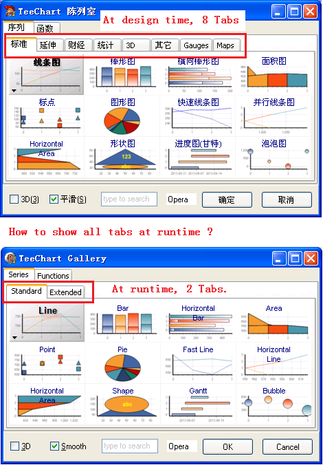

hi, my simple test program, the Chart Editor shows only two tabs at runtime, How to show all ?
00 Why only two page in Series.png (85.37 KiB) Viewed 4340 times

Post by Yeray » Tue Aug 27, 2013 4:01 pm
Add TeeEditPro and TeeWorldSeries units to the uses clause.
