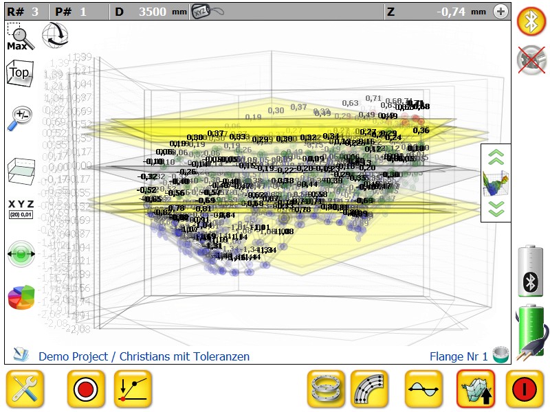

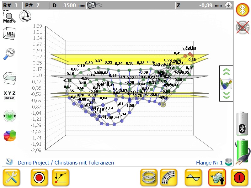

I've got a little problem with 3D charts and GDI+:
I use a TChart in 3D mode - a few Point3D series and 3-5 surface series.
If I turn on the GDI+ mode TTeeGDIPlus.Active and .Antialias the charts start blurring when it is moved by TRotateTool. (see the pictures attached)
If I click on the graph without moving - the blur reduces by each click. After more or less 10 clicks, the blur effect ist completely gone.
Any ideas on how to solve this ?
Delphi 7 - latest TChart 2013 Version
Thanks for any help in advance.
Blurred 3D chart - GDI+ and 3D series
- If clicking on the chart without moving, blur effect disappears
- Flange_unblurrred_after_10_times_click.jpg (122.39 KiB) Viewed 6639 times
- Picture from blurred chart after movement
- Flange_Blurred_by_Movement.jpg (141.83 KiB) Viewed 6617 times

Re: Blurred 3D chart - GDI+ and 3D series
Dear Christian,
Thanks for the example project.
I started stripping it to the basics and finally found the problem is with TSurfaceSeries transparency. Disabling it in your project makes blur disappear:
Then I found the minimal amount of code to reproduce the problem:
So I have added the issue (TV52016611) to the bug list to be fixed for future releases.
