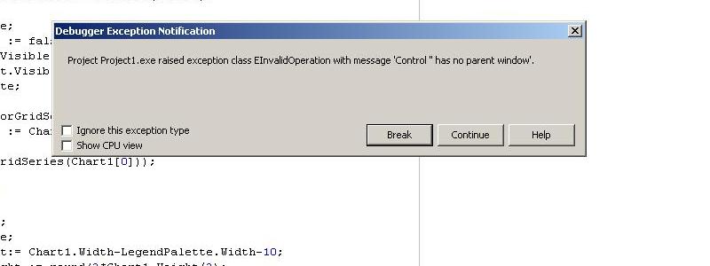

When I use the code below I get an error: "Control '' has no parent window"??
How do i fix that error??
Can You reproduce that error??

Friis
Posts: 23
Joined: Mon May 07, 2012 12:00 am
Re: Error in TColorGridSeries and TLegendPalette
Post by Friis » Wed Jan 02, 2013 11:37 am
You need to click on the chart in order to get the error
I have attached an image of the error message...
Posts: 9712
Post by Yeray » Thu Jan 03, 2013 8:23 am
Hi Hans,
I've found in another post you are using Delphi 2007, isn't it? Just to try it with the same environment than you, because it seems to work fine for me here with Delphi 7 and TeeChart v2012.07.
I've also tried the project attached above in Delphi 2007 with TeeChart v2012.07 and clicked around (on the series, on the legend, on the title,...), zoomed it, scrolled it,... and I can't get any error.
Please, check your installation is correct: check the library and search paths. And if the correct paths are present and on the top of the lists, you could try running TeeInstall.exe twice (one to uninstall and one to reinstall the component), and check the paths again.
Friis
Posts: 23
Post by Friis » Thu Jan 03, 2013 9:26 am
I'm using TeeChart V2012.05.120327 so I will update to V2012.07.
I'm using Delphi 2007, for Win 32, R2 Version 11.0.2902
Posts: 9712
Post by Yeray » Thu Jan 03, 2013 10:32 am
Hi Hans,
I've just seen how the problem was reproducible in TeeChart v2012.05 but in the actual v2012.07. So yes, I'd suggest you to upgrade.
