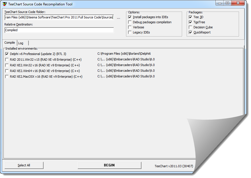

I did eventually also perform a Source Code recompile, selecting only Delphi 6 for the Build (BEGIN)
Steema07-May-12 8-40-31 PM.png (52.96 KiB) Viewed 4569 times

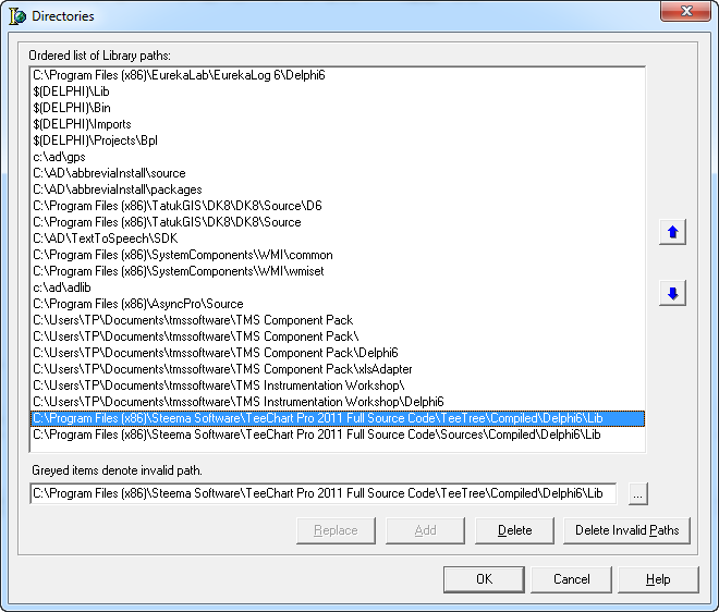

This is the Library path in Delphi 6:
Steema07-May-12 8-34-19 PM.png (28.49 KiB) Viewed 4560 times
However, the Steema version 12 library path was defined in the Project Options Search path, which must have overwritten the Library Path. I have removed from Library Path and the chart is OK (well almost)

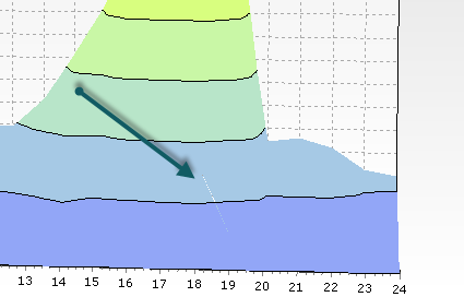

Steema07-May-12 8-46-04 PM.png (9.61 KiB) Viewed 4563 times
Thank you for the support.

Track1 wrote:This is the Library path in Delphi 6:
The screenshot shows the library list for your Delphi 6, at "Tools\Environment Options...\Library\Library path". Note more references could also be defined in the project search path, at "Project\Options...\Directories/Conditionals\Search path". You could clear this list since the references are already in the library list.
The library list in your screenshot look correct for using TeeChart v2011. Anyway, I'd suggest you to move the TeeChart references to the top of the list to be sure the TeeChart files are used if there is any coincidence with files from other references in the list.
Track1 wrote:However, the Steema version 12 library path was defined in the Project Options Search path, which must have overwritten the Library Path. I have removed from Library Path and the chart is OK (well almost)
This is what I get with TeeChart v2011.03 and Delphi 6 with the application you attached some posts above:
The screenshot looks as taken from another application, right?
Note this problem could be very related to the dataset used. If you found the problem isn't reproducible with a dataset but with another, please try to arrange a simple example project again, so we can check it there too.
