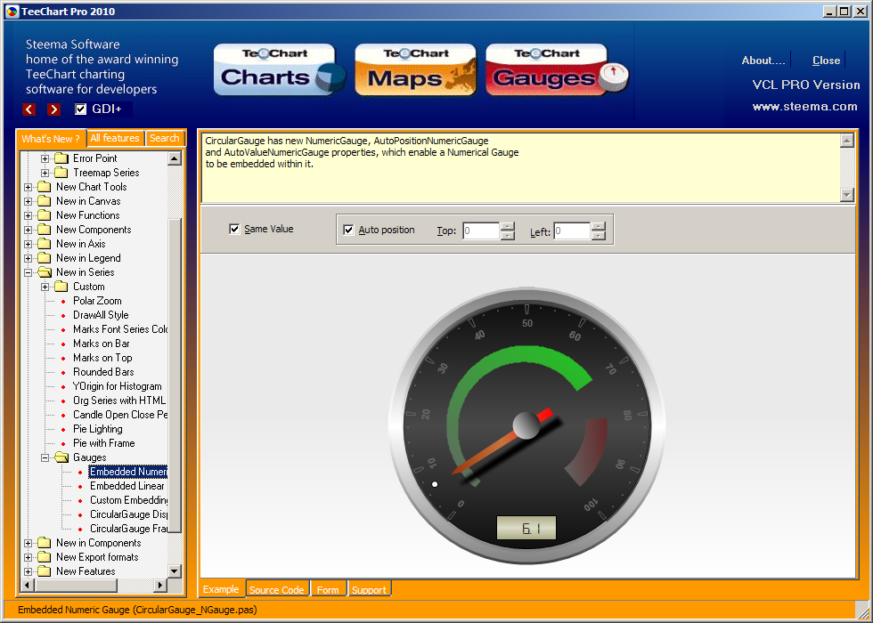

Please, take a look at the examples in the features demo under "What's New !\Welcome !\New in Series\Gauges".
Here it is one of them:

Thanks, yes I have looked at that but still cannot create what I see on the site. The chart I am trying to create is:
[img]src="file:S:/Scratch%20Pad/Multi%20Needle%20Gauges.png"[/img]
When I try (using the code shown in Tee9New) I get an error saying TGaugeSeries does not have property Embedded.
Am I missing something?

Re: Combination Gauges
Post by Narcís » Wed Jun 22, 2011 2:56 pm
Hi Jamie,
As can be read under the image, this chart was created using SubChart tools. You can find SubChart examples at: What's New?\Welcome!\New Features\Tools\SubCharts and All Features\ Welcome!\Tools\SubCharts in the new features demo, available at TeeChart's program group.
Hope this helps!
