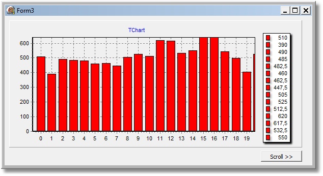

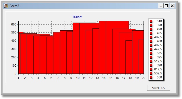

If you setup the property Points per Page you will see the problem.
The first image shows the graph when the application fires up (as suggested by your example).
The second image shows the graph after I press the Scroll button that trigger Chart1.Axes.Bottom.Scroll(1);
Please, see the images below:
Before Scroll:
Before Scroll
After Scroll:
After Scroll

Re: Scrolling problems
Post by Yeray » Mon May 23, 2011 12:04 pm
Hello Miguel,
I've been able to reproduce it with v8.05 and v8.06 but it's not reproducible anymore for me here from v8.07.
Could you please try the v8.07 or the v8.08?
