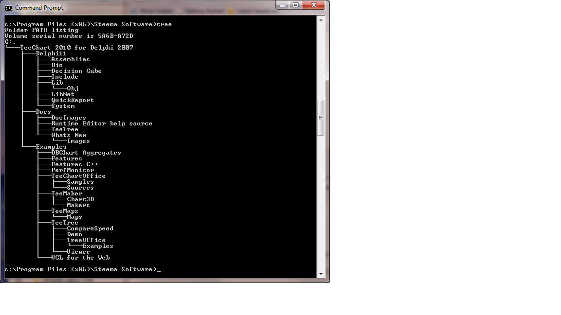

We are using the demo version, so we don't have any sources, but there is no file on my machine that has the name TeeHTML5Canvas. Here is my steema directory structure after installing the demo.
Directory structure

Hi tmecham,
Excuse me. I'm not sure why I thought you were a source code customer.
We are investigating why the unit isn't in the Lib folder of the installations.
In the meanwhile, you can use the dcu+dfm attached. Please extract the contents into Lib folder in your TeeChart installation.
