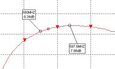

With TeeChart 7.07 for Delphi6, I would like to display single mark on a LineSeries when, for exemple, I click on a Series point.
None of the Marks properties or methods (Marks.item[].visible, etc.) fit my needs until now.
An example of what I would like to do :
- I display a TLineSeries on a TChart (no Marks at that moment)
- I move the mouse over the Series and the nearest point is displayed, (using the NearestPoint Tool)
- I decide to click on a particular point, and a mark is displayed at that point.
- I can now move this mark (using the DragMarks tool).
I know how to use the NearestPoint and DragMarks Tools, but I don't find any convenient way to display single/custom/individual Marks...
Thanks for any advice,
Laurent

Narcís wrote:Hi Laurent,
What about using TMarksTipTool?
Hi Narcis,
As I've seen of the TMarksTipTool behaviour, it won't fit my needs.
Here's a sample of a soft that really does exactly what I want :
The Marks are individually painted on the chart when the series point is clicked.
... and no, I don't have the source code of this soft :(
(... but I'm sure it uses TeeChart component !)
I've tried to use the series.marks.items.add method but failed because of lack of understanding the 'pointer' parameter...
By clicking on series points, I get their valueindex, but I don't know what to do with them to display the related marks (and only them !)
Laurent

Narcís wrote: Ok, this is most likely done using TAnnotationTool object and its Callout object. If you need to drag those tools you'd better use TRectangleTool instead of TAnnotationTool.
Hope this helps!
Narcis,
I've tried the TRectangleTool, but the object used in the sample enclosed above mostly behaves like a mark, and not like an Annotation.
Nevertheless, I'll try to go further in the Annotation direction, and also through the Series.Marks.Items.add().

lolo1988 wrote:Well, the RectangleTool is finally not so easy to use as a marks displayer.
It is not enough connected with the series points, and things like resizing the chart is tough to manage (the callout is connected to a screen point, not a serie point...)
Too complicated (and too much time consumer) to implement for me.
Here you have an approach. You only have to recalculate the positions of the tools each time the chart is resized, zoomed, scrolled,... calling the same "recalc" method into all the events you want.

I use C++ Builder for my projects. I have similar requirements of displaying markers as discussed here. I have tried to convert your code to C++ Builder, but no success. My difficulties are 1) I can not declare an array of TRectangleTool, 2) I could not assign a marker from TRectangleTool *marker, to a Chart by Chart->Tools->Add().
Could you show an equivalent code in C++Builder?
Shen
Posts: 9715
Re: Displaying single marks
Post by Yeray » Tue Jan 11, 2011 4:11 pm
Hi Shen,
Here is the code in C++Builder. I've simplified it a little bit to use an static array for CustomMarks instead of the dynamic array in the delphi example.
