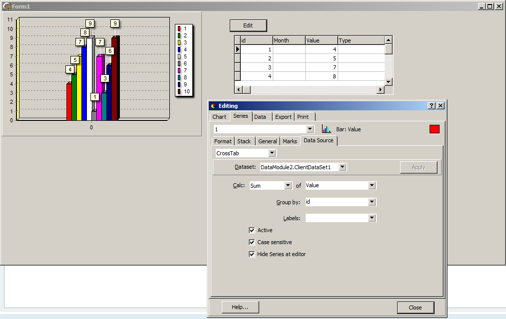

Re: IsValidDataSource is not used in TDBChartCrossTabEditor
Hi Jørgen,
Could you please tell us the exact steps we should follow with your testing application to reproduce the problem here?
Here is what I'm getting:
You have done it correct
The problem is that all datasets are available for crosstab source.
ClientDataset2 should not be on the list.
If you try to use a dataset as source you can see that only ClientDataset1 is available.
Jørgen
Jørgen
Hi Jørgen,
We've seen that TDBChartCrossTabEditor doesn't access to IsValidDataSource because it inherits from a different class than TBaseSourceEditor.
We've also seen that setting SkipValidation as False in TDBChartCrossTabEditor.FormShow into TeeDBCrossTab.pas the problem seem to be solved.
We'll continue investigating the issue and we'll be back to you asap.
Hi Jørgen,
Actually this behaviour is as designed. What causes validation being skipped is SkipValidation property. As Yeray told you, setting it to false at TDBChartCrossTabEditor.FormShow method in TeeDBCrossTab.pas does what you request.
