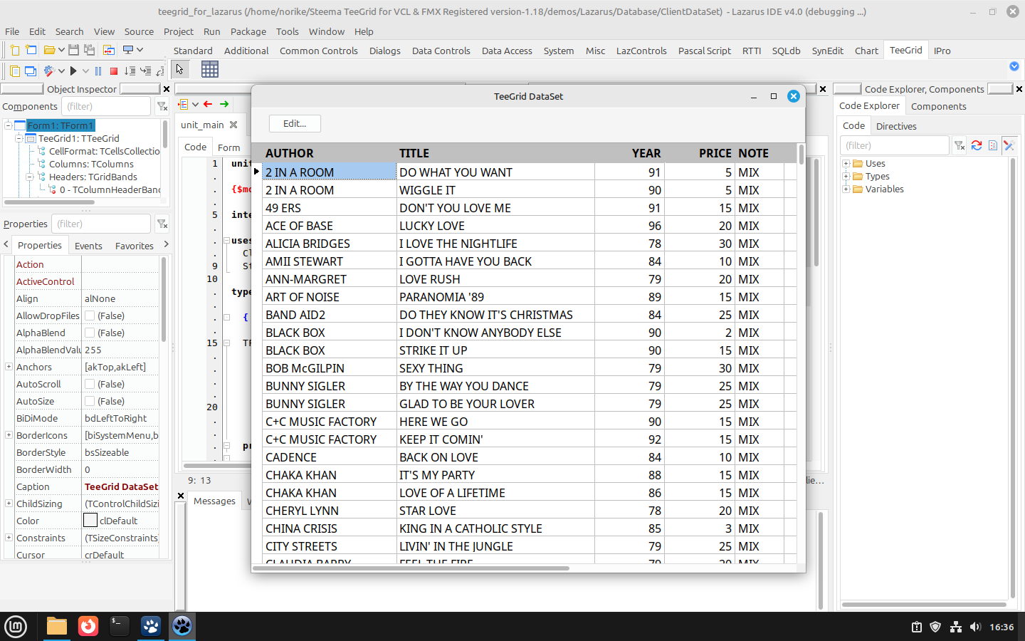

I've just tested it with a fresh install of a Linux Mint:
TeeGrid in Linux Mint Cinnamon 22.1 .png (230.17 KiB) Viewed 10483 times
