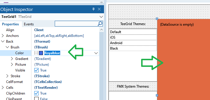

Post by QDavid » Fri Apr 07, 2023 11:28 am
In Delphi 11.2 + Firemonkey , does not support AlphaColors?
Image attached..
Thks.
QDavid
Joined: Mon Aug 26, 2019 12:00 am
Re: Color Problem
Post by QDavid » Sat Apr 08, 2023 9:30 pm
Width this change in the original code of the unit Tee.Format , seems to work correctly.
class function TColorHelper.Swap(const AColor:TColor):TColor;
{  Original Code
  TAlphaColorRec(result).R:=TAlphaColorRec(AColor).B;
  TAlphaColorRec(result).G:=TAlphaColorRec(AColor).G;
  TAlphaColorRec(result).B:=TAlphaColorRec(AColor).R;
  TAlphaColorRec(result).A:=TAlphaColorRec(AColor).A;
  // Changed code
  TAlphaColorRec(result).R:=TAlphaColorRec(AColor).R;
  TAlphaColorRec(result).B:=TAlphaColorRec(AColor).B;

Re: Color Problem
Post by Marc » Tue Apr 18, 2023 9:34 am
Thanks for the feedback. We'll take a look at the best way to meet TColor and TAlphaColor requirements.

Re: Color Problem
Post by TheOtherPrefontaine » Fri Sep 22, 2023 2:32 am
This exact bug was in the aggpas delphi port.
