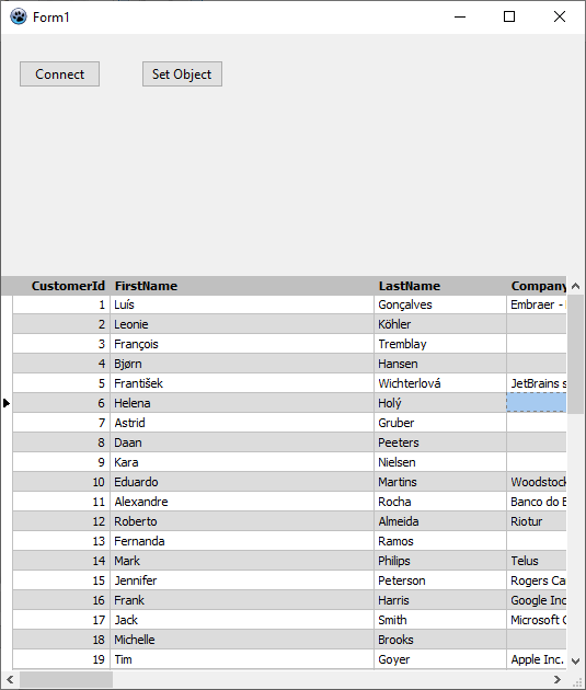

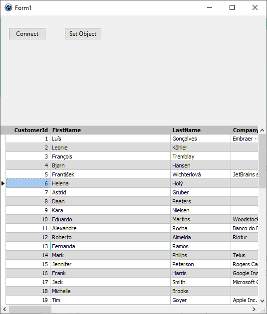

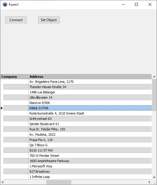

When navigating with the keyboard (moving right). A column that is not in full view, is only being shown *after* the user leaves the cell. Leading to a situation that the user will not see the content of the column.
In the attached images you can see what happens to the "company" column when navigating (View in chronologic order k1 , k2, and then k3.png)

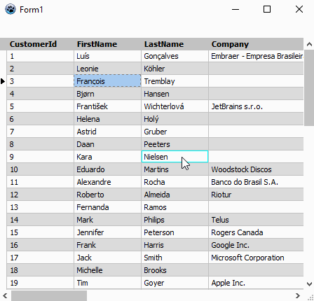

Re: Usability Issue: Keyboard navigation doesn't put the column into view correctly
Thank you for the example project. I am able to run it.
I haven't seen anything that prohibits the free movement or view of the wider field when moving with keys. I attach an image, please let me know if you see something quite different.
With thanks.
I suppose I didn't explain myself... You can see the issue I talked about in the example you prepared.
Look at the "company" column on the first row, you never see the entire content of it. Only after the user leaves the column and moves to the "address" you see the rest of the name. but never its entirety.
In my opinion a much better behavior would to the scroll the column into view once the user enters the column.
