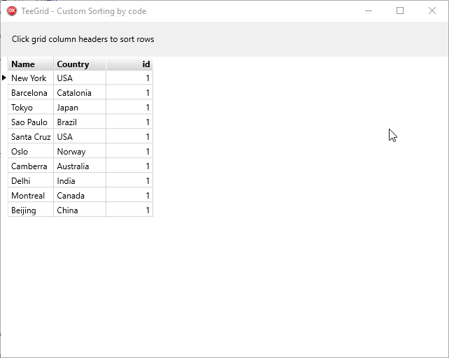

I have attached your demo (Unit_Custom_Sorting.pas/fmx) with an added column of type integer so that you can reproduce the behavior.
The following happens, if you click on any of the three columns everything works as expected.
The unexpected behavior occurs when in the new column "id" the focus is placed in some cell of that column and click on the header of the column "id", to change the order.
At that time the width of all columns grows to a size that does not fit in the grid and the grid becomes unmanageable.
This behavior I have only observed in columns that contain numbers. that's why I added the id column as integer.

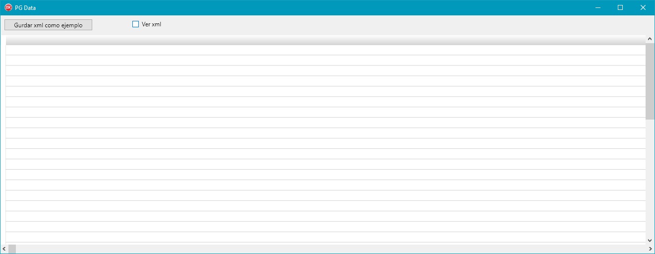

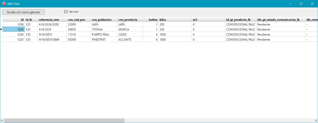

I attached images of the appearance before and after the problem.
- After sort o reopen and cell focus on numerico column
- After sort or reopen.jpg (82.79 KiB) Viewed 67183 times
- Before sort o reopen and cell focus on numerico column
- Before sort or reopen.jpg (81.36 KiB) Viewed 67183 times
