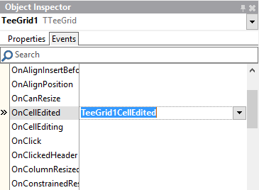

It works for me in TeeGrid v1.03 adding it as any other event: DoubleClick the white box next to the event in the Object Inspector to create the event:
