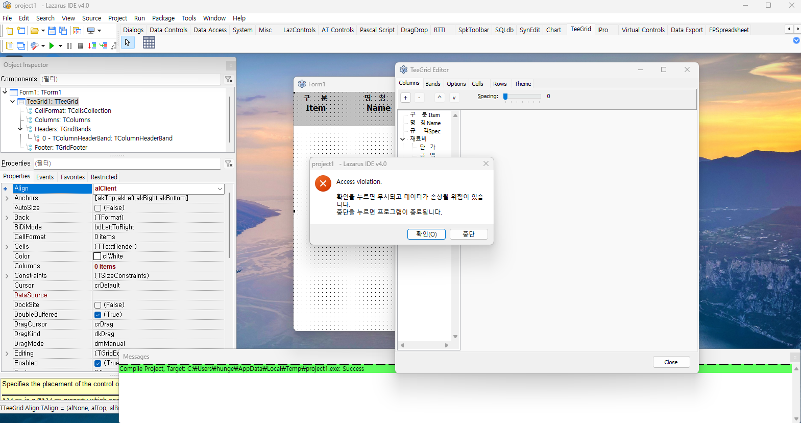

However, the program crashes while editing the Columns title using the Editor. I tested it using Lazarus 4.0, I'll test it a bit more and ask again if it's still a problem.

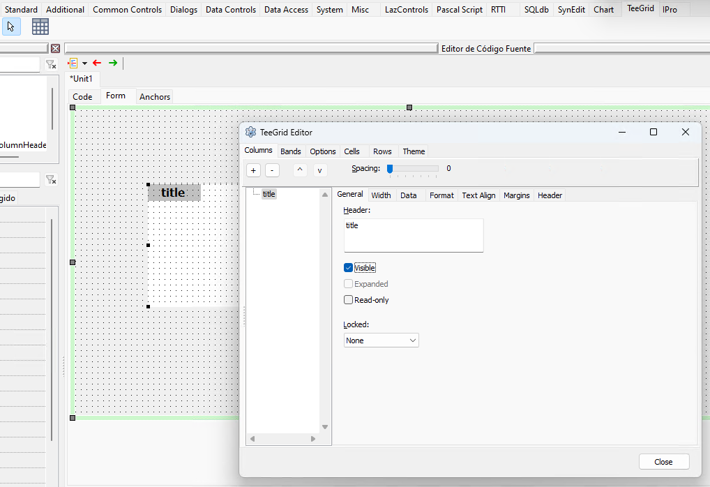

I've been playing with the Colums Title without observing any crash.
Could you please detail what should I do to reproduce the problem?

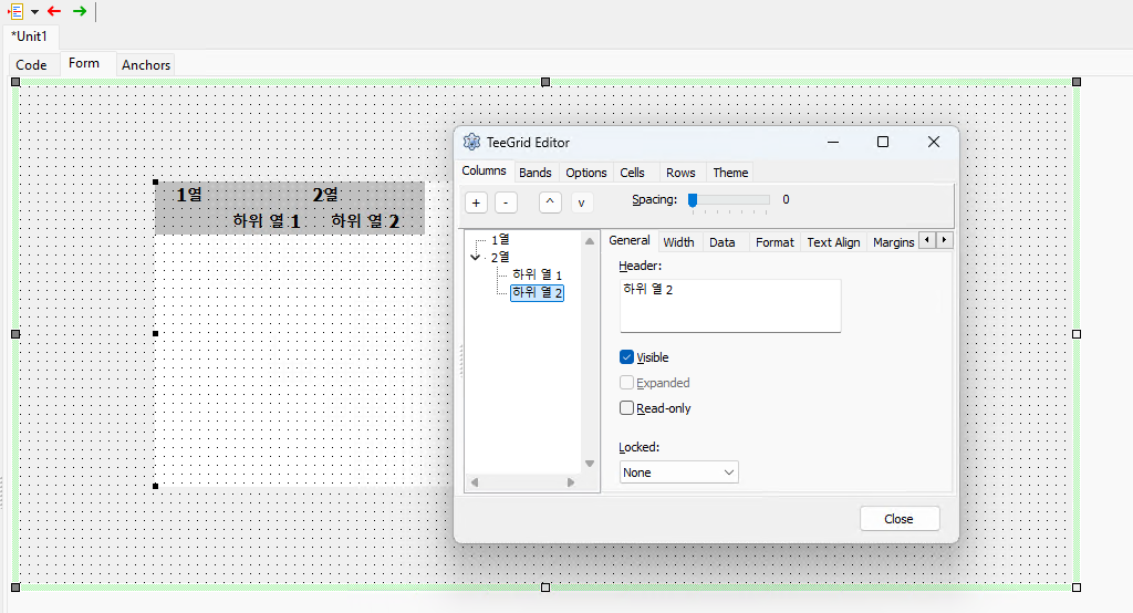

Post by Pegasus » Wed Jul 09, 2025 11:25 am
Most of the time it works fine. But sometimes when I input Header text (in Korean) and click somewhere else like ListBox (when Memo Box where Header text is input loses focus), Lazarus freezes.
This happens sometimes. So it's hard to explain the specific situation where it happens.
Error Full.png (457.8 KiB) Viewed 15096 times

I've been adding and removing columns without any freezing so far.
If you find a solid way to reproduce the problem, please don't hesitate to let us know.
