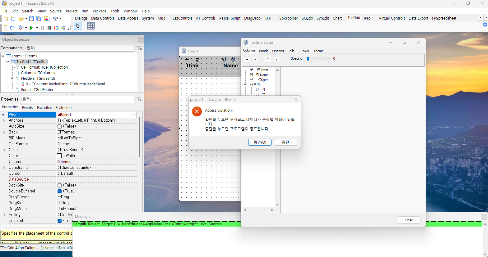

Re: Error message : Identifier not found "vkSpace"
Most of the time it works fine. But sometimes when I input Header text (in Korean) and click somewhere else like ListBox (when Memo Box where Header text is input loses focus), Lazarus freezes.
This happens sometimes. So it's hard to explain the specific situation where it happens.
