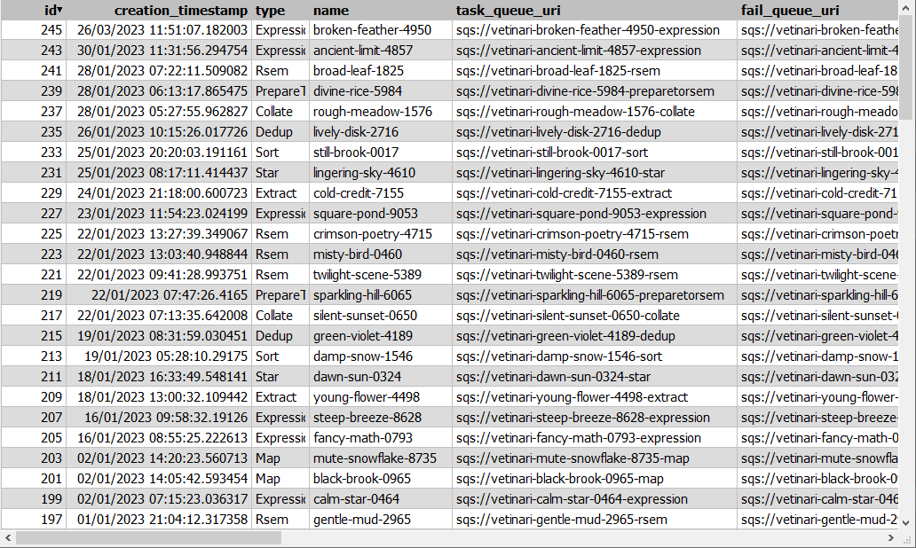

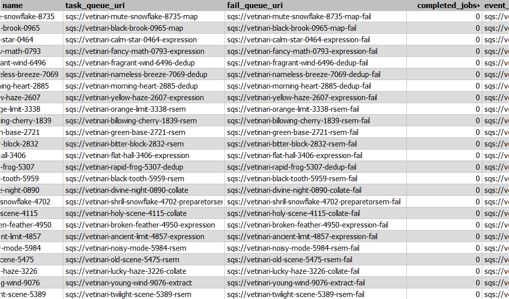

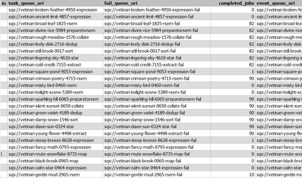

To recreate:
1. The user scrolls vertically (to the right) and put into view a column that was not first visible
2. Then sorts by this column
The grid scrolls back back to the left (the sort is being maintained)
I'm using: windows 10, Lazarus 2.2.4, Grid 1.1

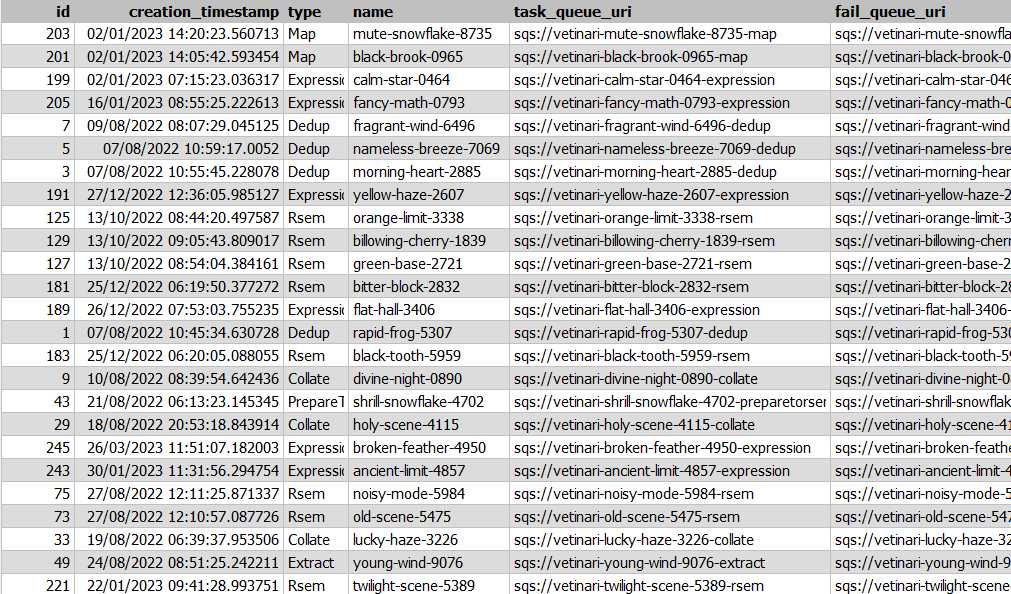

Post by stoffman » Fri Apr 07, 2023 2:25 am
Missing is the first state of the grid:
