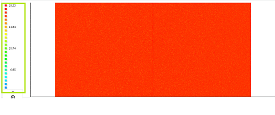

Thanks for your reply. I'm attaching the screenshot here. Here we have 400 scans(series) in Color Grid. Based on series values legend values(Min and Max) are plotting. If I'm wrong correct me. If we have single series and if we change Min and Max values of axis then it will plot based on what we have changed. Like that can we change in color grid ? If we can how to do that? or do we need to change Array of series based on min and max values. Please give me some solution.

Yes, the Legend min and max are ranged from the ColorGrid Series' min and max values.Based on series values legend values(Min and Max) are plotting
Re.
If you change Axis Min and Max (could use the Axis SetMinMax method for example) the Axis will range to those values but the values of the ColorGrid itself will remain unchanged; it'll remain at the Axis values that represent its x and y cell locations. That could result in a space at the end of the Axis, or cutting off some data if the Axis is shorter.if we change Min and Max values of axis
Re.
Yes, you'll need to do that if you wish to influence the Legend min and max. The Legend, whether you use a palette of few or many colours, will range between the Series min and max data values. The more colour values you apply to the grid palette, the more sensitivity you will see in representing the difference of data values in the grid.do we need to change Array of series based on min and max values
