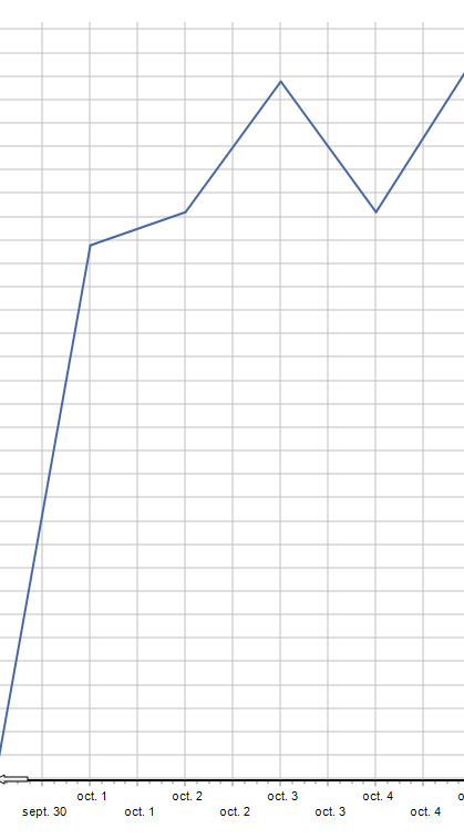

I've a problem to export from VCL to HTML JScript.
When I don't use automatique increment, the labels of Bottom Axis are not visible.
You can find the application in attachement.

Post by Yeray » Wed Sep 14, 2016 10:38 am
I could reproduce the problem, so I added a ticket in the public tracker:
http://bugs.teechart.net/show_bug.cgi?id=1630
I also fixed it for the next maintenance release.
Since you own the sources, you can apply the fix by changing the following lines in the EmitAxis method in TeeJavaScript.pas:

Also note in your bottom axis I see you've set DateTimeFormat as 'dd/MM/yyyy HH:MM' but the character to represent minutes is "n" in delphi, while "m" is used for months (reference here). So I'd change it for this:
  Chart1.Axes.Bottom.DateTimeFormat:='dd/MM/yyyy HH:nn';

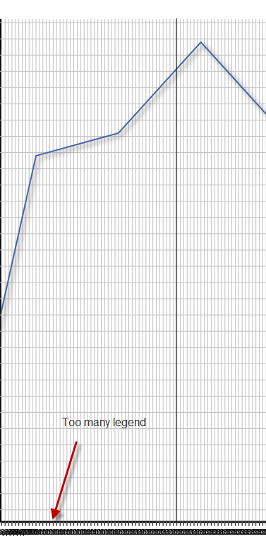

Would-it possible like in vcl chart to limit automaticaly the number of legend displayed?

Menant.D wrote:Would-it possible like in vcl chart to limit automaticaly the number of legend displayed?
This seems to be the bottom axis labels, not the legend.
There may be some difference on how both versions handle the increment in the axis. Could you please arrange a simple example project we can run as-is to reproduce the problem here?

You're right, it concern labels of bottom Axe.
The difference is where we put an increment(one day for example) in automatic increment.
You can see it in the project join.

Post by Yeray » Fri Sep 16, 2016 8:55 am
This is because the increment property in TeeChart HTML5 is a bit different than in TeeChart VCL.
http://bugs.teechart.net/show_bug.cgi?id=1632
