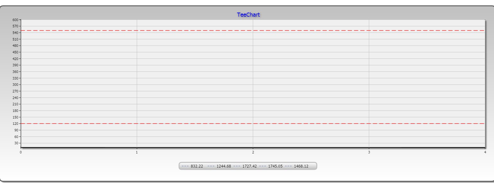

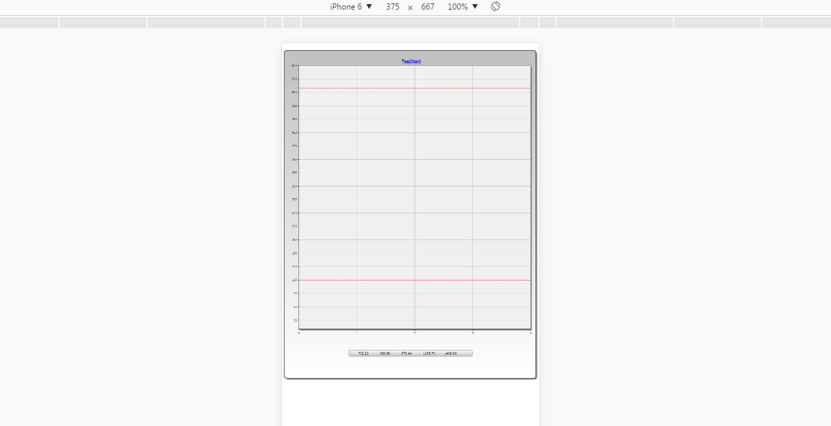

I have written the below logic to draw the dash line that is displayed on the graph and works fine for desktop browsers. The problem is that the solid line is drawn when I tested using mobile devices and google mobile device tool. Also the the line( dash or sold ) is not displayed when I tested using IE 10 and Edge.
Is there any way to fix this issue? I wanted to draw only dash line for all mobile and desktop browsers. I attached the screenshot here for your reference

Screenshot for desktop browser
screenshot for mobile view(Iphone 6)

Try drawing the lines with moveTo/lineTo instead of using the rectangle function. Ie:
                var c = chart1.ctx;
                c.beginPath();
                c.moveTo(xBelowAlarm1, yBelowAlarm1);
                c.lineTo(xBelowAlarm2, yBelowAlarm2);
                c.lineWidth = myFormatBelowAlarm.stroke.size;
                c.strokeStyle = myFormatBelowAlarm.stroke.fill;
                c.setLineDash(myFormatBelowAlarm.stroke.dash);
                c.stroke();
                c.beginPath();
                c.moveTo(xAboveAlarm1, yAboveAlarm1);
                c.lineTo(xAboveAlarm2, yAboveAlarm2);
                c.lineWidth = myFormatAboveAlarm.stroke.size;
                c.strokeStyle = myFormatAboveAlarm.stroke.fill;
                c.setLineDash(myFormatAboveAlarm.stroke.dash);
                c.stroke();
SenSeo
Posts: 71
Joined: Wed Mar 09, 2016 12:00 am
Re: Draw dash line - mobile issue
Post by SenSeo » Mon Jul 11, 2016 5:57 am
Thanks. It is working now
