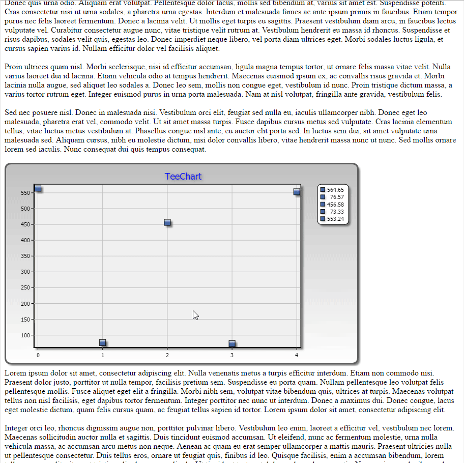

In my graph, I am using tooltip to display the details. The problem is, during the tooltip visible I am scrolling the mouse, at that time tooltip is traversing with the mouse pointer throughout the page.

Can you please assist me to fix the tooltip traversing issue?

Is this what you mean?
Re: Tooltip traversing with mouse pointer.
Posted: Wed Jun 01, 2016 10:13 am
by 15677821
Yes correct.

Not only for mouse pointer move... It is happening for scroll too.

  tip.domStyle = "padding-left:8px; padding-right:8px; padding-top:0px; padding-bottom:4px; margin-left:5px; margin-top:0px;";
  tip.domStyle = tip.domStyle + "background-color:#FCFCFC; border-radius:4px 4px; color:#FFF; ";
  tip.domStyle = tip.domStyle + "border-style:solid;border-color:#A3A3AF;border-width:3; z-index:1000;";
  Chart1.tools.add(tip);
  tip.ongettext = function (tool, text) { return '<font face="verdana" color="blue" size="1">' + "Text:\n" + text + '</font>'; }
  Chart1.legend.visible = false;
  Chart1.draw();

In some scenarios the traversing issue is happening.

As an extra check, you can use the body's mousemove event and hide the ToolTip if the mouse is out of the chart canvas:
            var canvas = document.getElementById('canvas');
            var body = document.body;
            body.addEventListener('mousemove', function(evt) {
                var rect = canvas.getBoundingClientRect();
                if ((evt.clientX < rect.left) || (evt.clientX > rect.right) || (evt.clientY < rect.top) || (evt.clientY > rect.bottom)) {
                    tip.hide();
            }, false);

This solution is not working for me. I am having more than 4 pages and each page contains the tee chart graph with tooltip display. If I go with the body's mousemove event, it is working only for one page. For the remaining pages tooltip is not displaying. Is there any other solution available to fix this issue?
