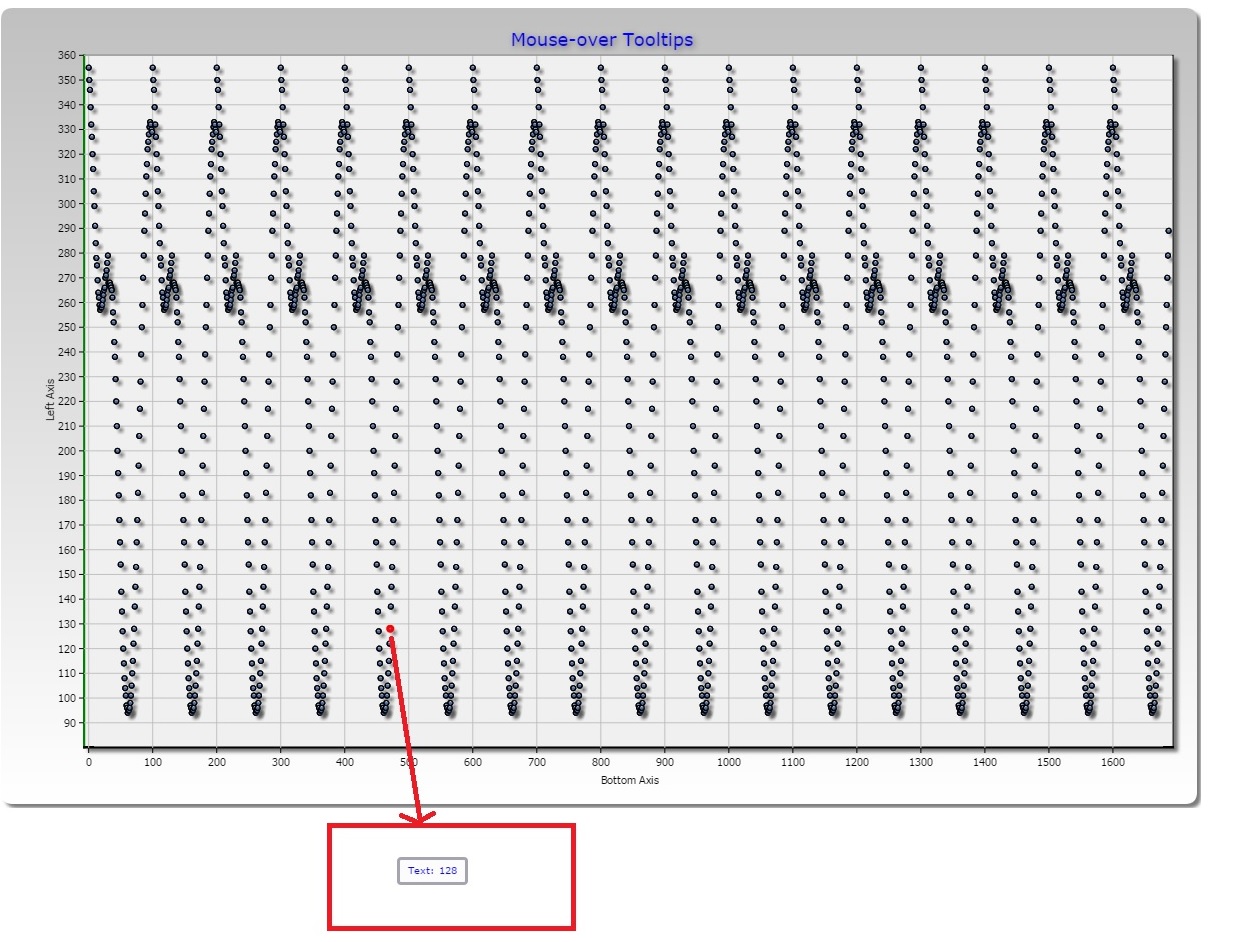

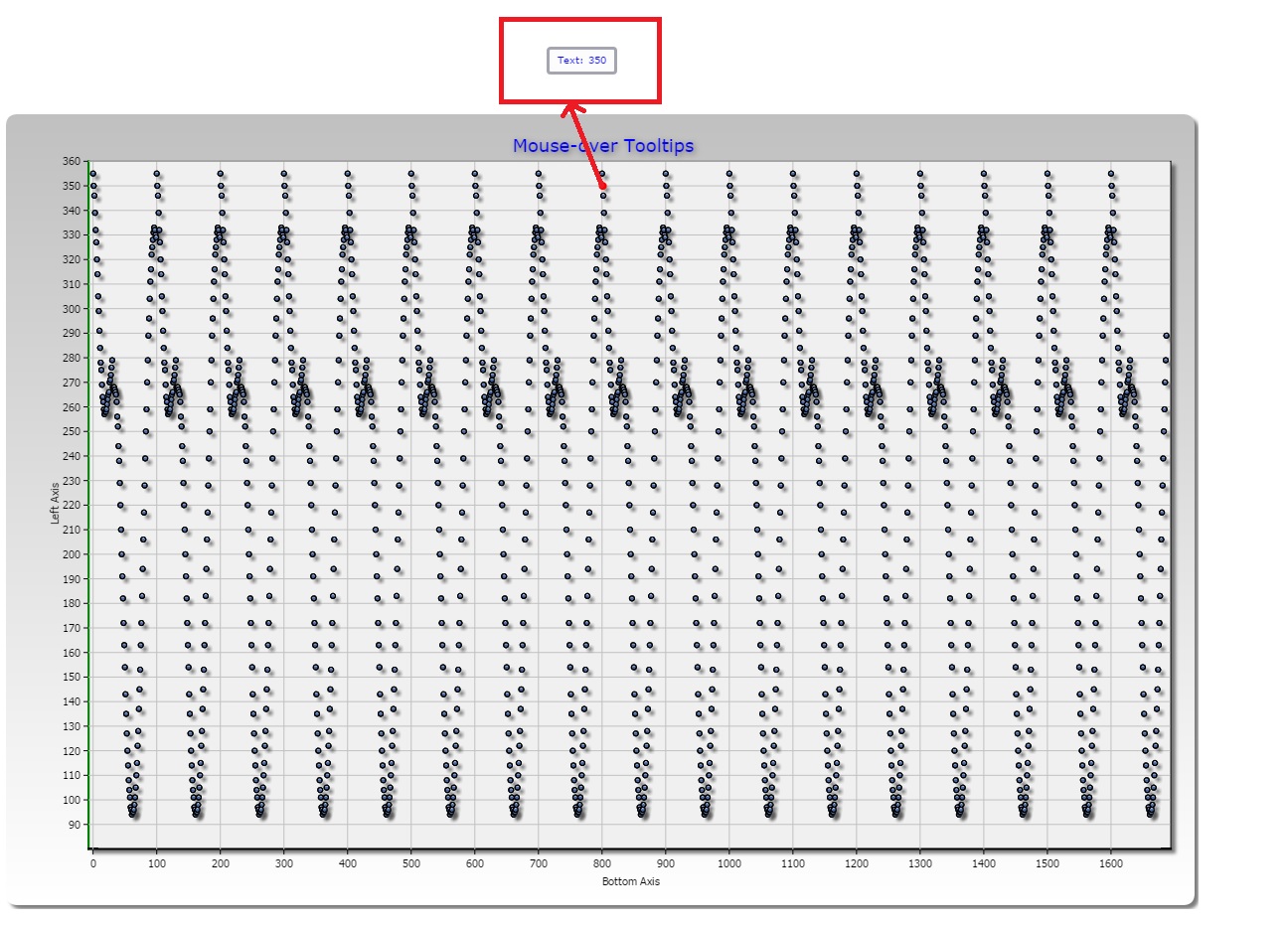

In my graph, I am using tooltip to display the details. The problem is, during the tooltip visible I am scrolling the mouse, at that time tooltip is traversing with the mouse pointer throughout the page.
Below is my code to display the tooltip,
                    var tip = new Tee.ToolTip(Chart1);
                    tip.render = "dom";
                    tip.autoHide = false;
                    tip.domStyle = "padding-left:8px; padding-right:8px; padding-top:0px; padding-bottom:4px; margin-left:5px; margin-top:0px; ";
                    tip.domStyle = tip.domStyle + "background-color:#FCFCFC; border-radius:4px 4px; color:#FFF; ";
                    tip.domStyle = tip.domStyle + "border-style:solid;border-color:#A3A3AF;border-width:3; z-index:1000;";
                    Chart1.tools.add(tip);
                    //tip.onhide = function () { scaling = 0; poindex = -1; }
                    tip.ongettext = function (tool, text, series, index) {
                        var toolTipValues = ["abc","xyz"];
                        var s = '<font face="verdana" color="blue" size="1">' + toolTipValues[index] + '</font>';
                        return s;
Can you please assist me to fix the tooltip traversing issue?

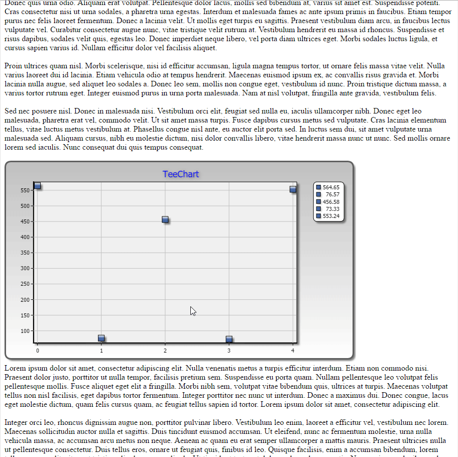

Is this what you mean?

Yes correct.

Not only for mouse pointer move... It is happening for scroll too.

Still we are facing the tooltip traversing issue in some scenarios. If the series data values contains N no. of records, traversing issue is happening. This is not happening for the minimum amount of data's. Any insights?

Below is my sample code which is having huge amount of data's.

In some scenarios the traversing issue is happening.

Post by Yeray » Thu Jun 09, 2016 11:12 am
As an extra check, you can use the body's mousemove event and hide the ToolTip if the mouse is out of the chart canvas:
            var canvas = document.getElementById('canvas');
            var body = document.body;
            body.addEventListener('mousemove', function(evt) {
                var rect = canvas.getBoundingClientRect();
                if ((evt.clientX < rect.left) || (evt.clientX > rect.right) || (evt.clientY < rect.top) || (evt.clientY > rect.bottom)) {
                    tip.hide();
            }, false);
