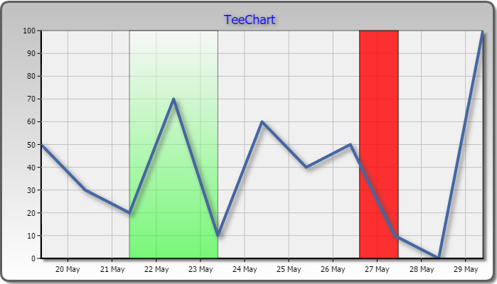

First of all note the Custom Paint example in the demo draws a rectangle/shape. Here I modified it to draw an horizontal ColorBand:
http://www.teechart.net/support/viewtop ... 043#p71201
Taking that as a reference, I've modified the example to use datetime values for the bottom axis, and to draw two vertical ColorBands.
Note I've used slightly different approaches to draw them. The fist one uses a gradient and series values as x1 and x2; the second uses a single color and directly datetimes to calulcate x1 and x2:

            line1.beforeDraw=function() {
                var x1 = Chart1.axes.bottom.calc(line1.data.x[2]),
                    y1 = Chart1.chartRect.y,
                    x2 = Chart1.axes.bottom.calc(line1.data.x[4]),
                    y2 = Chart1.chartRect.y + Chart1.chartRect.height;
                // X,Y, Width, Height
                myFormat1.rectangle(x1,y1, x2-x1, y2-y1);
                x1 = Chart1.axes.bottom.calc(today + 7 * oneDay + 5 * oneHour),
                x2 = Chart1.axes.bottom.calc(today + 8 * oneDay + 2 * oneHour),
                myFormat2.rectangle(x1,y1, x2-x1, y2-y1);
            Chart1.draw();
    </script>
