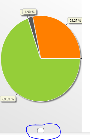

The legend is not resized along with the canvas when we access the chart for mobile devices. Below function is used to resize the chart and legend.

Is there any way to fix the legend issue for a mobile device?
Resize issue
Lengend_resize issue.PNG (29.16 KiB) Viewed 9609 times

There's a demo that does a resize and it looks fine for me in a smartphone:
https://www.steema.com/files/public/tee ... resize.htm
Does it reproduce the problem you are reporting?
