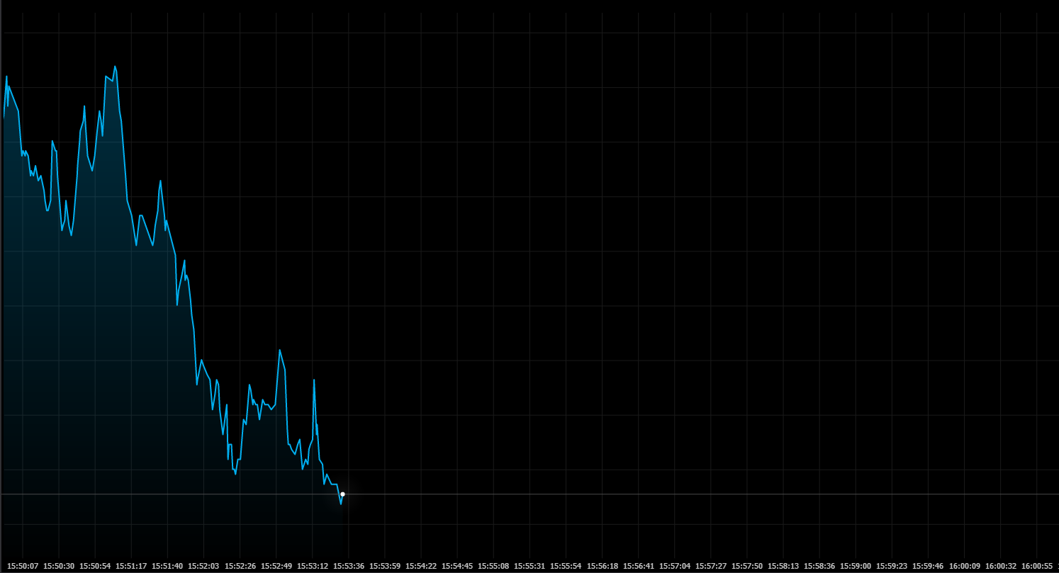

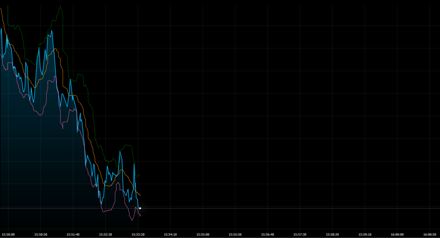

we need from your help about the Bollinger Bands indicator
The bands are calculating from all data as is below:
but the lines are very curved now. We want to make lines more smooth and straight.
When try to use only one fifth part of all data we lost the lines as is below:
Please advice how can achieve it.
