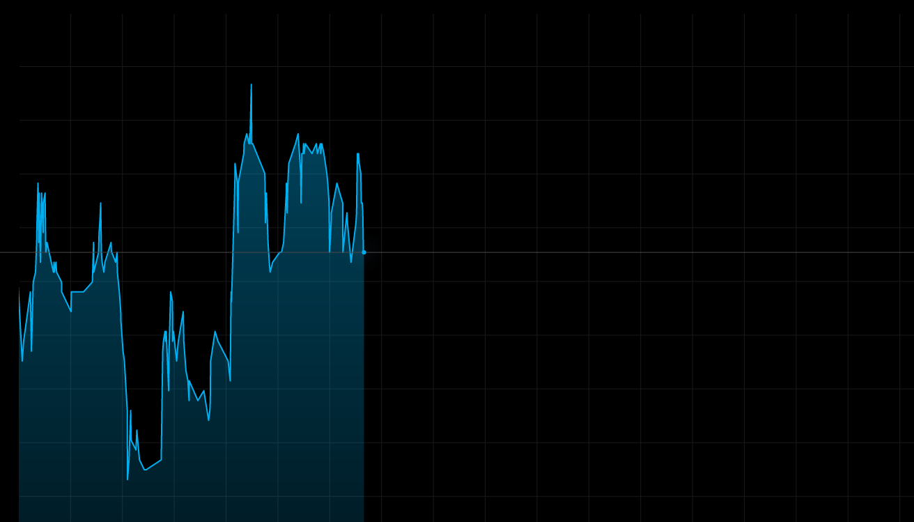

Screencasts attached here below:
After changing
regular one

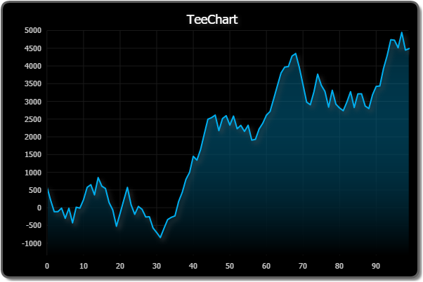

This is how it looks:
Note I've used useOrigin and origin properties to set the bottom of the gradient.

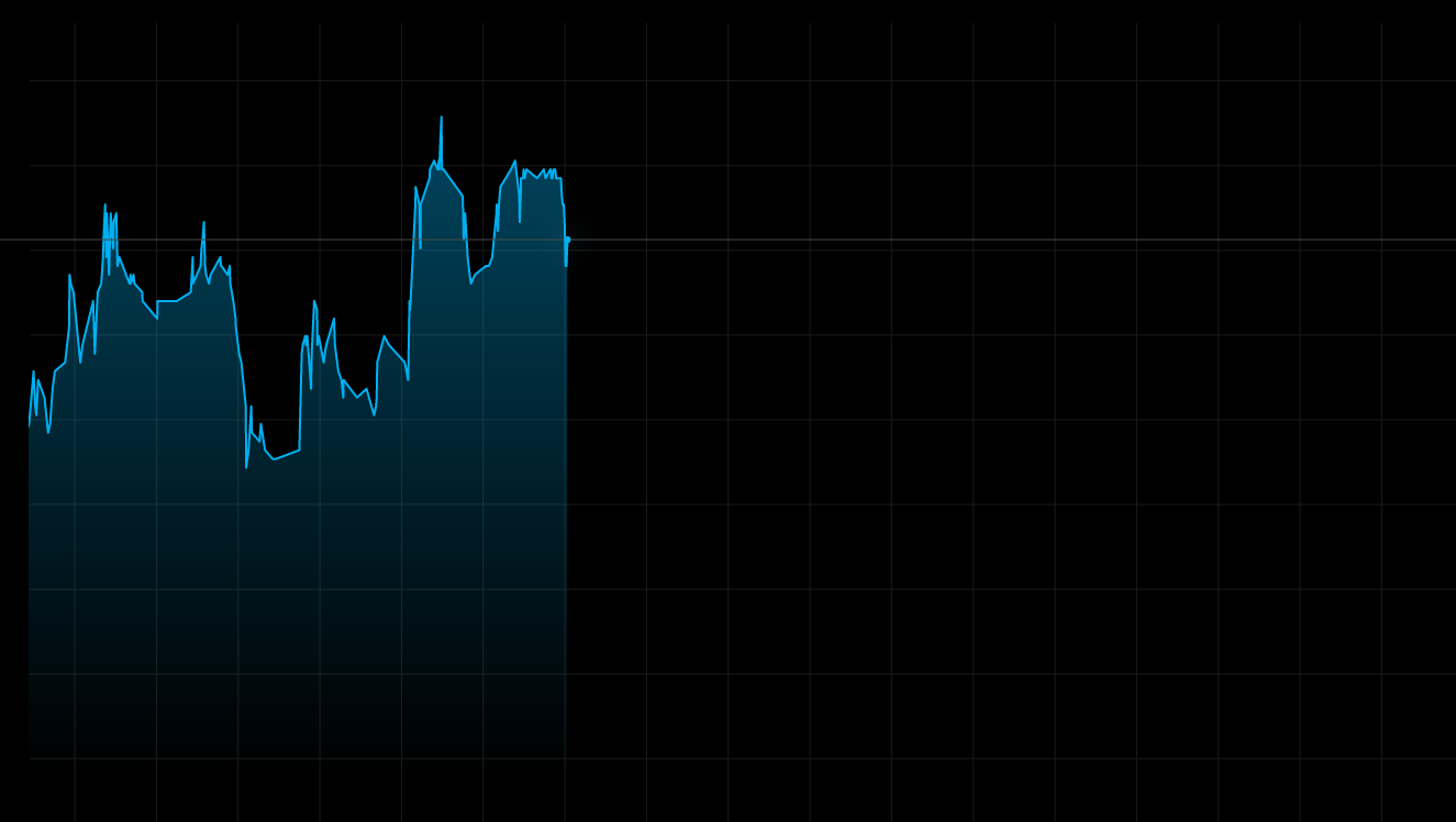

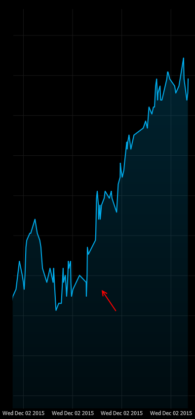

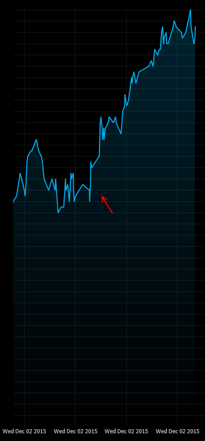

I've made 2 screenshots, one before and anotherone after the axis rescale.
Using a simple drawing program (ie Paint.NET) I capture the color of a pixel from each screenshot, both corresponding to the same zone, and I get the same value. In the point I highlighted in both screenshots I'm getting RGB=(0, 19, 27):
before
after
So it seems to me that the gradient is kept after changing the axis scale.

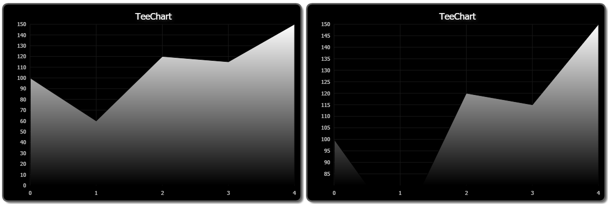

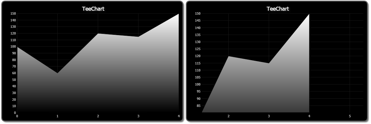

Thanks for the example page. I just changed the example and scrolled to the left side
<!DOCTYPE html>
<html>
<head>
<title>Testing</title>
<script src="teechart.js" type="text/javascript"></script>
<script src="date.format.js" type="text/javascript"></script>
    <script type="text/javascript">
        var Chart1, Chart2;
        function draw() {
            Chart1 = new Tee.Chart("canvas1");
            Chart2 = new Tee.Chart("canvas2");
            createArea(Chart1);
            createArea(Chart2);
            Chart1.axes.left.setMinMax(0, 150);
            area1 = Chart1.series.items[0];
            area1.useOrigin = true;
            area1.origin = Chart1.axes.left.minimum;
            Chart2.axes.left.setMinMax(80, 150);
            area2 = Chart2.series.items[0];
            area2.useOrigin = true;
            area2.origin = Chart2.axes.left.minimum;
            Chart1.draw();
            Chart2.draw();
        function createArea(chart) {
            chart.title.format.font.fill = "white";
            chart.legend.visible = false;
            chart.panel.format.gradient.visible = false;
            chart.panel.format.fill = "black";
            chart.walls.visible = false;
            chart.axes.bottom.grid.format.stroke.fill = "#191919";
            chart.axes.left.grid.format.stroke.fill = "#191919";
            chart.axes.bottom.labels.format.font.fill = "#ccc";
            chart.axes.left.labels.format.font.fill = "#ccc";
            chart.scroll.enabled = true;
            chart.scroll.mouseButton = 0;
            chart.scroll.direction = "horizontal";
            var area = new Tee.Area();
            chart.addSeries(area);
            area.data.values = [100, 60, 120, 115, 150];
            area.format.shadow.visible = false;
            area.format.stroke.visible = false;
            area.format.fill = "black";
            area.format.gradient.visible = true;
            area.format.gradient.colors[0] = "white";
    </script>
</head>
<body onload="draw()">
    <br>
    <center>
    <canvas id="canvas1" width="600" height="400">
    </canvas>
    <canvas id="canvas2" width="600" height="400">
    </canvas>
</center>
    <br>
    <svg id="usa" class="map" width="100%" height="100%" />
</body>
</html>
Re: Area chart gradient bug
Post by Yeray » Wed Dec 09, 2015 2:50 pm
I see the gradient is drawn considering a rectangle with a height calculated taking this minYValue:
  this.minYValue=function() {
    var v=this.yMandatory ? Tee.Series.prototype.minYValue.call(this) : Tee.Series.prototype.minXValue.call(this);
    return this.yMandatory ? this.useOrigin ? Math.min(v,this.origin) : v : v;
In the code you've just posted, the smaller YValue on the series is 60 and origin is 80, so the Math.min(v,this.origin) call above returns 60 and the gradient is calculated considering the bottom of the rectangle at 60.
You can change that overriding the minYValue function for the area2. Ie:

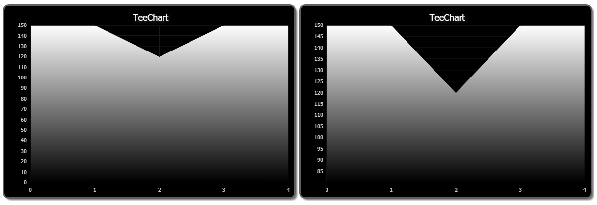

        function draw() {
            area2.minYValue=function() {
            return this.yMandatory ? this.useOrigin ? this.origin : v : v;
            Chart1.draw();
            Chart2.draw();
g.todorov

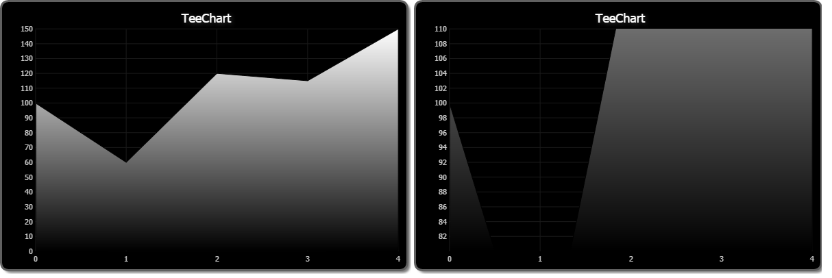

It seems works but in our real situation we change min and max together with a near values.

Could you please give us a solution where the maxY is also included in the calculations if it possible of course.
In all cases we want to keep the gradient perfectly.
