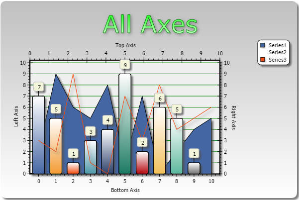

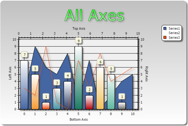

To see the axis grid color clearly, I've hidden the grid of all the axes except for one. Then, I've added this to the draw() function in that example before Chart1.draw():
  Chart1.axes.left.grid.format.stroke.fill="black";
  Chart1.axes.top.grid.visible=false;
  Chart1.axes.right.grid.visible=false;
  Chart1.axes.bottom.grid.visible=false;
Or on "green":
  Chart1.axes.left.grid.format.stroke.fill="green";
