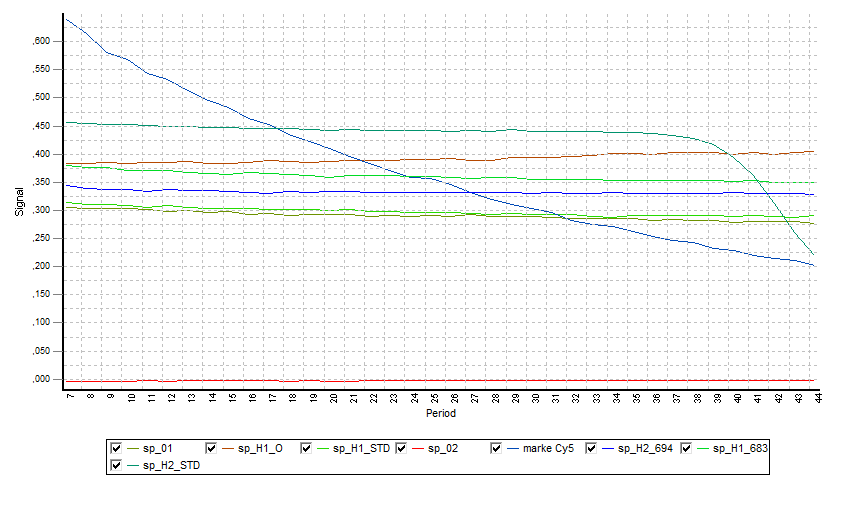

Problem 1: The key (targo1, targo2, targo3 /please, see code-example) should appear at each legend item.
Problem 2: I’ve added checkboxes, similar to your demo (Basic Example), generated by JavaScript using DOM. Is there a possibility to merge checkboxes with legend/ color of series (short line, please, refer to image below)?
Thanks, Juliane

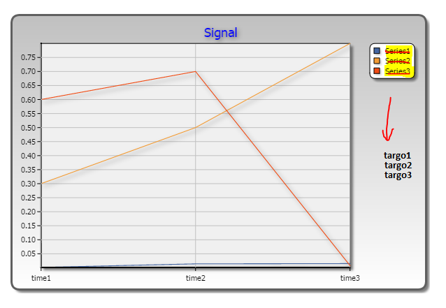

matt
Posts: 13
Joined: Fri Nov 07, 2014 12:00 am
Re: Legend with Custom Labels
Post by matt » Wed Mar 25, 2015 11:23 am
Hello Yeray,
Thank you for your reply.We need the custom labels at the legend, maybe the image below can visualize 'Problem 1'. The labels at bottom axis are different.
Regards, Juliane

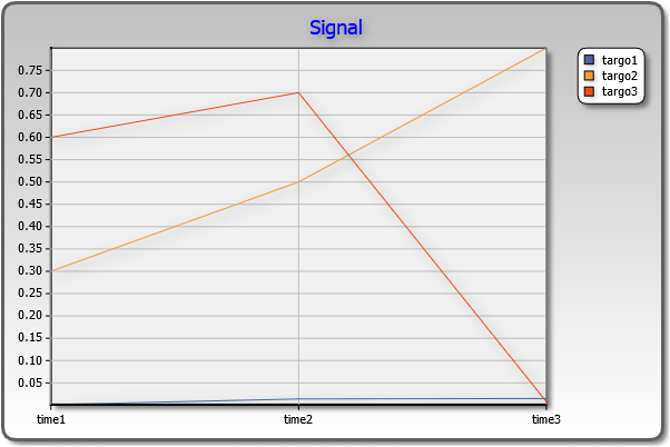

Post by Yeray » Thu Mar 26, 2015 8:24 am
Hi Juliane,
Try adding this inside the for-loop in your serchart function:
vdata.title = key;
This is the how complete function looks like:
    function serchart(chart_ser, taros, vdata_x, x_labels) {
        for (key in taros) {
            key_array.push(key);
            taro_vals_strings = taros[key];
            var val_array = [];
            for (var k = 0; k < taro_vals_strings.length; k++) {
                val_array.push(taros[key][k]);
            vdata = new Tee.Line();
            vals = val_array;
            vdata.data.values = vals;
            vdata.data.x = vdata_x;
            vdata.title = key;
            chart_ser.addSeries(vdata);
            console.log(vdata);
            //key should appear as legend item
        chart_ser.title.text = "Signal";
        lineData = vdata;
        var vfont = chart_ser.title.format.font;
        chart_ser.axes.bottom.labels.ongetlabel = function (value, s) {
            return x_labels[value]
        chart_ser.draw();
And this is what I get here:
