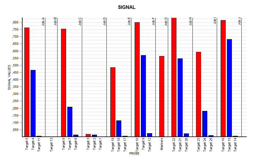

I need to group several bars within one series (because there is a relation in between) and to draw an annotated Line (e.g. Job A) for visual separation. Concerning that topic I studied the example code for multiple axes and tried to adopt it but not yet successfully. The snapshot shows a Tee-Bar-Chart-example which is realized in VB6, but I have to implement it by HTML5/JavaScript. Any help would be nice.
Thanks, Juliane
Tee-Bar-Chart-example, realized in VB6

Do you have a simple example in VB6 we can take as model?

The data structure looks like this: attached code. The values for the targets are derived from variable “bar_data”. The requirements are the following:
Groups of targets are to be shown in given order.
Group name (job) must be recognizable for related targets.
The bar of first target of group is to be shown in different color.
The font size of labels for targets should be resized automatically in case there are lots of bars to be shown.

Re: Group bars/draw line to separate bar groups/add axes?
Post by Yeray » Fri Dec 19, 2014 2:54 pm
Hello ,
Take a look at this variant.
I'm manually drawing the vertical lines and the "group" texts:
