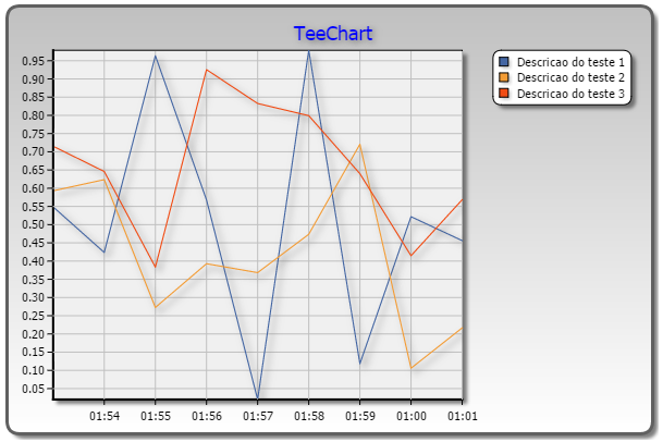

Thanks but I still don't understand what resultant chart would you expect. Something like this?
var Chart1;
function draw() {
  Chart1=new Tee.Chart("canvas1");
  var series1, series2, series3;
  series1 = Chart1.addSeries(new Tee.Line());
  series2 = Chart1.addSeries(new Tee.Line());
  series3 = Chart1.addSeries(new Tee.Line());
  series1.title = "Descricao do teste 1";
  series2.title = "Descricao do teste 2";
  series3.title = "Descricao do teste 3";
  var startDate, tmp, values1, values2, values3;
  startDate = new Date(2014,12,4,14,30,53);
  values1 = [0.54881, 0.42365, 0.96366, 0.56804, 0.02022, 0.97862, 0.11827, 0.52185, 0.45615];
  values2 = [0.59284, 0.62356, 0.27266, 0.39278, 0.36824, 0.47361, 0.72063, 0.10591, 0.21655];
  values3 = [0.71519, 0.64589, 0.38344, 0.92560, 0.83262, 0.79916, 0.63992, 0.41466, 0.56843];
  series1.data.values.length = values1.length;
  series2.data.values.length = values2.length;
  series3.data.values.length = values3.length;
  series1.data.values = values1;
  series2.data.values = values2;
  series3.data.values = values3;
  series1.data.x=new Array(values1.length);
  series2.data.x=new Array(values2.length);
  series3.data.x=new Array(values3.length);
  for (i=0; i< values1.length; i++) {
    tmp=new Date(startDate.getTime() + i * 1000);
	series1.data.x[i] = tmp;
	series2.data.x[i] = tmp;
	series3.data.x[i] = tmp;
  Chart1.axes.bottom.labels.dateFormat = "mm:ss";
  Chart1.axes.bottom.increment = series1.data.x[1] - series1.data.x[0];
  Chart1.draw();

Yes, this is the chart that I want. But, before this (and this is my problem), I need transform my JSON table and if I'm not wrong, using this (http://steema.com/entry/133/Introducing ... ot_library)
So, In resume, I need transform the first table (see it in the first message) into the second table (see it here http://www.teechart.net/support/posting ... 19#pr67971) and in addition to plot the chart, I need show the transformed data on a table (made in JS/HTML by me). So I need to know how access the transformed data. Do you understand-me?
