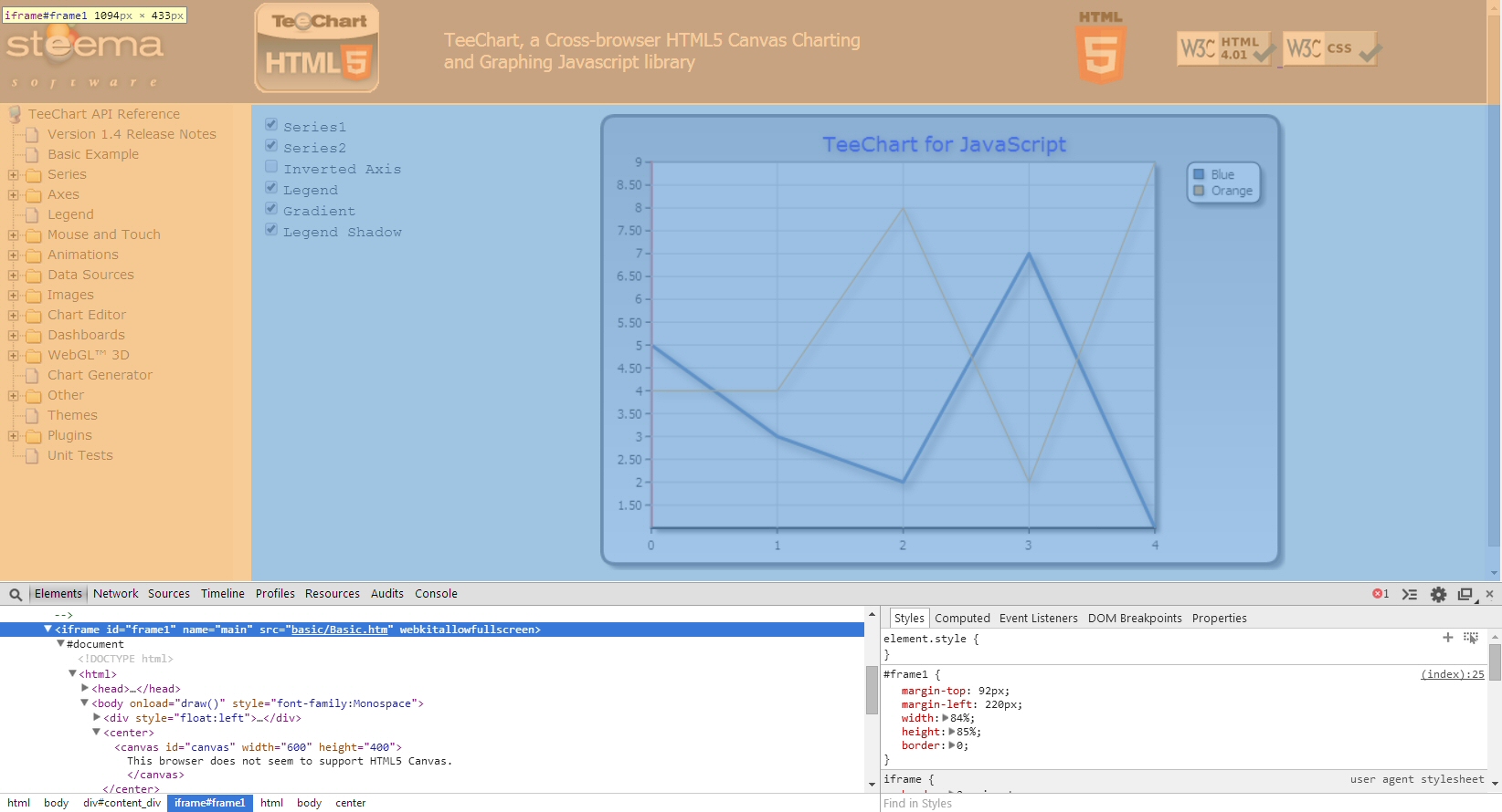

All of your examples I've seen place the canvas in an iframe. Is there something special about that? I would guess it's because a) you get a resize event to redraw the Chart, and b) it handles output from TeeSaveToJavascriptFile.

The second example (http://www.steema.com/files/public/teec ... 1.4/demos/) is also using an iframe. See the attached screen shot of a Chrome session.

Yes, but this is to separate the tree on the left and the example on the right.
If you open the example in a new tab, or following this link to see the example without the tree, you won't see any iframe in the example.
