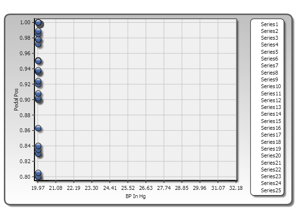

In this image I told the x label to be "20,22,25,26,27.5,28.5,29.875,32" but in the image it does not show all the data?

Excuse us for the delayed reply here.
Could you please share the code you used to generate that chart so we can reproduce the problem here?

sure, seems though its not the code because the vary same code is use to produce all charts. Some charts look ok, some are missing labels.
Here is an example of missing labels.
this.Ydata = 20,22,25,26,27.5,28.5,29.875,32
this.Zdata = 1,1,1,1,1,1,1,1,0.8,0.83,0.9,0.936,1,1,1,1,0.8,0.83,0.9,0.936,1,1,1,1,0.805,0.835,0.902,0.938,1,1,1,1,0.84,0.863,0.92,0.951,1,1,1,1,0.908,0.924,0.95,0.972,1,1,1,1,0.978,0.978,0.985,0.989,1,1,1,1,1,1,1,1,1,1,1,1
this.labelY = Pedal Pos
this.labelX = BP In Hg
     chart.prototype.draw = function ()

I'm trying to get what you reported in the first post in this thread with the code you've pasted, but this is what I get:
Here it is the full testing unit I'm using. Could you please tell us if you are getting the same with it? Can you please modify it so we can reproduce the problem here?

Sorry about that, the second string needed element separators.
this.Zdata = [[1, 1, 1, 1, 1, 1, 1, 1], [0.8, 0.83, 0.9, 0.936, 1, 1, 1, 1],

after viewing your example I see its correct. So in an effort to figure it out I change the size to
<br><canvas id="canvas1" width="400" height="400">
and now the missing data shows up. So this may be related to the other issue (TF77016700)

Thanks for the feedback. I've added it to the ticket (TF77016700) description.
