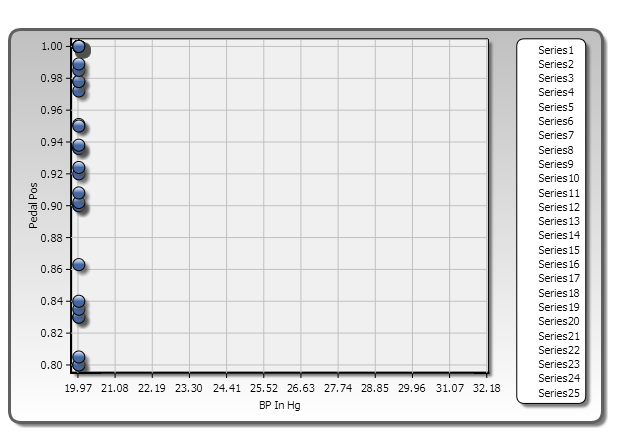

In this image I told the x label to be "20,22,25,26,27.5,28.5,29.875,32" but in the image it does not show all the data?
- missing_data.png (43.65 KiB) Viewed 21399 times

sure, seems though its not the code because the vary same code is use to produce all charts. Some charts look ok, some are missing labels.
Here is an example of missing labels.
this.Ydata = 20,22,25,26,27.5,28.5,29.875,32
this.Zdata = 1,1,1,1,1,1,1,1,0.8,0.83,0.9,0.936,1,1,1,1,0.8,0.83,0.9,0.936,1,1,1,1,0.805,0.835,0.902,0.938,1,1,1,1,0.84,0.863,0.92,0.951,1,1,1,1,0.908,0.924,0.95,0.972,1,1,1,1,0.978,0.978,0.985,0.989,1,1,1,1,1,1,1,1,1,1,1,1
this.labelY = Pedal Pos
this.labelX = BP In Hg

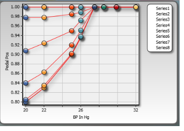

I'm trying to get what you reported in the first post in this thread with the code you've pasted, but this is what I get: Here it is the full testing unit I'm using. Could you please tell us if you are getting the same with it? Can you please modify it so we can reproduce the problem here?

Re: some times lables have missing data.
after viewing your example I see its correct. So in an effort to figure it out I change the size to
<br><canvas id="canvas1" width="400" height="400">
and now the missing data shows up. So this may be related to the other issue (TF77016700)
