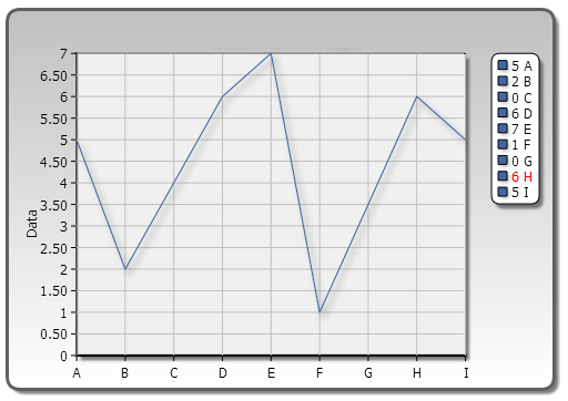

var Chart1;
        function draw() {
            Chart1 = new Tee.Chart("canvas1");
            Chart1.axes.left.title.text = "Data";
            var series = new Tee.Line(Chart1);
            Chart1.addSeries(series);
            series.data.values = [5, 2, null , 6, 7, 1,null  , 6, 5];
            series.data.labels = ['A', 'B', 'C', 'D', 'E', 'F', 'G', 'H', 'I'];
            Chart1.draw();
no break line

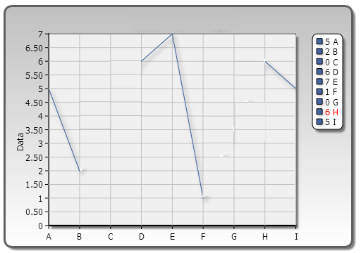

How to set a break line in point B to point D & point F to point H like this
Re: Null Value & Axes Title Angle and Show Time In Multiple Axes
Post by Yeray » Thu Jan 17, 2013 8:43 am
We've added a new treatNulls property to the Line series so with the next maintenance release you'll be able to do this:
Chart1.series.items[0].treatNulls = "skip";   // default is:  "dontPaint"
