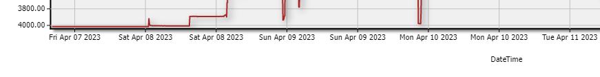

I having date format issues
it should be 00:00:00 07-Apr-2023
     this.TChart.axes.bottom.visible = true;
      this.TChart.axes.bottom.labels.dateFormat = "HH:mm:ss dd-MMM-yy";
      this.TChart.axes.bottom.title.text = "\nDateTime";
      this.TChart.axes.bottom.grid.visible = true;
      this.TChart.axes.bottom.automatic = true;
        for (var t = 0; t < _data.xData.length; t++) {
       	   // sample date from data  "2023-04-06T21:26:05.72-05:00"
          const _date_ = new Date(_data.timeStampData[t]);
          this._series0.data.x[t] = _date_ ;
Posts: 1317
Location: Girona
Re: Date Format Issue
Post by Marc » Tue May 02, 2023 2:37 pm
I've added an option in the combo here, custom3:
https://www.steema.com/files/public/tee ... tetime.htm
code:
Chart1.axes.bottom.labels.dateFormat = "hh:mm:ss d-mmm-yy";
