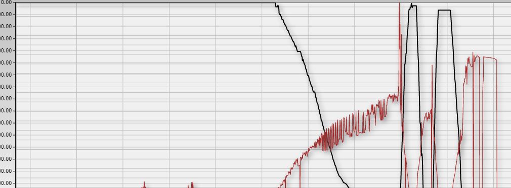

I am unable to use palette colors for the line series.
I would like to display colors based on the line series seen in the image. this image is made from.net steema chart
 for (var t = 0; t < _data.xData.length; t++) {
        this._series0.data.values[t] = _data.yData[t];
        this._series0.data.x[t] = new Date(_data.timeStampData[t]);
        this._series0.palette.colors[t] =_data.colorData[t];

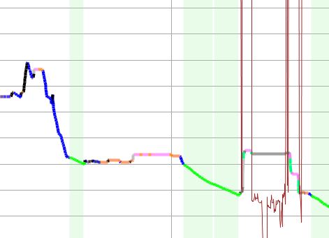

This is normally achieved by using the series.colorEach property but that influences the colour of line-pointers (when visible) and not the line itself, We are modifying the TeeChart code to include colorEach for the line segments themselves.
Ref: https://www.steema.com/bugs/show_bug.cgi?id=2609

I think its fixed , how can I used it
Posts: 1317
Location: Girona
Re: How can I use palette color or multiple grid color based on data range ?
Post by Marc » Tue May 09, 2023 3:54 pm
Yes, the latest npm update, v3.0.1, https://www.npmjs.com/package/TeeChart, includes the modification.
Use via:
Chart1.series.items[0].colorEachLine="yes";   //or true

Post by aaron » Sun May 14, 2023 10:25 am
Thanks, Its working now :D :D :D :D :D :D :D
