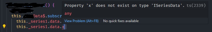

  • I have been facing package issues called "Teechart". there is no definition file in the package.
  • If I added manually Teecahrt with the definition file, there is a restriction to accessing some of the properties.

I'll check with a compilation on the latest version. The public demo links the data in this way:
https://www.steema.com/files/public/tee ... echartjsA/

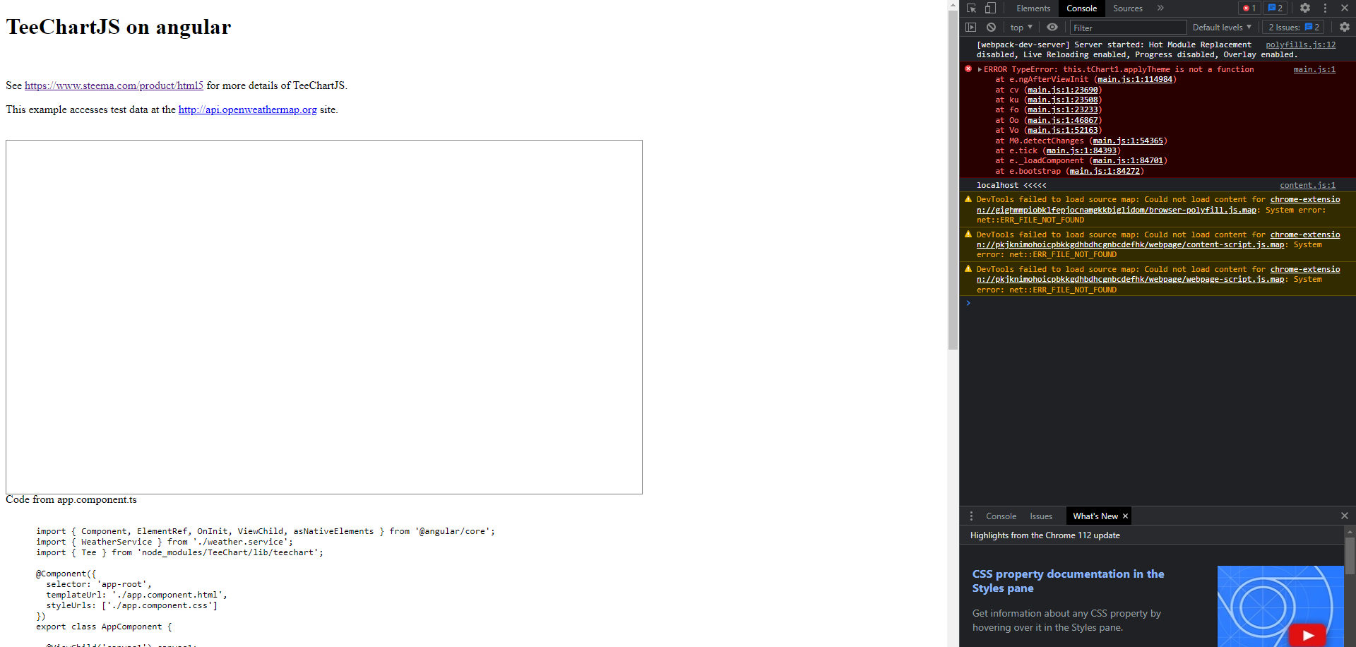

Then, Why I am getting this error?

I can't tell why you're seeing that error. There's not a lot to go on from that screenshot.
I've uploaded the working example here:
https://github.com/Steema/TeeChart-Java ... ns/angular

I follow the URLs and cloned the project and I follow the readme instruction
  • npm install @angular-devkit/build-angular
  • npm install canvas
Now :?: :?: :?: :?: :?: :?: :?: :?: :?: :?: :?: :?: :?: :?:

It looks like you need to download the change made at the repository or apply the comment:
//this.tChart1.applyTheme("minimal");
as described here:
https://www.steema.com/support/viewtopi ... 18&t=17897
