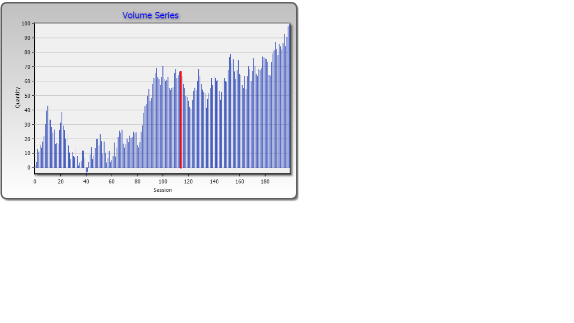

I'm trying to recreate the attached image using javascript. I want to highlight a specific bar with a specific colour.
Something like:
  Chart1.series.items[0].data.values[117].format.stroke.fill="red";
or
 Chart1.series.items[0].data.ValuesIndex[117].ValueColour("red");
How would I do that?
I'd appreciate any suggestions or help on how to achieve it. Many thanks.

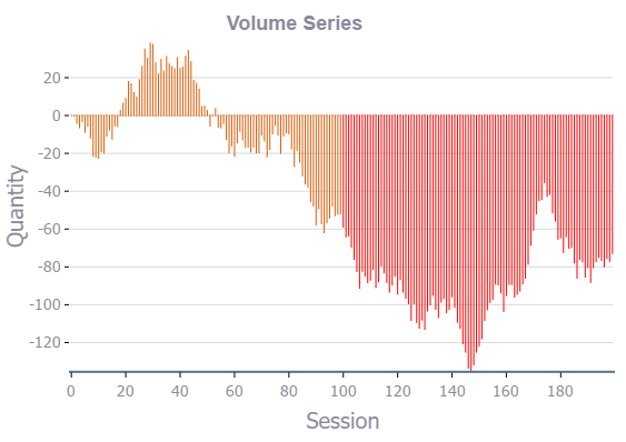

Thanks for the quick response, but unfortunately I can't get this to work using your volume graph demo?
Taking the volume example from your demo, I added the code below and nothing changes:
            volume.palette.colors = [];
            for (var i=0; i<volume.count(); i++) {
                if (i<100)
                    volume.palette.colors[i] = volume.format.fill;
                    volume.palette.colors[i] = "red";
Using your own demo with this addition should make the remaining 100 random bars red. But they don't?
Please help.
Thank you.
Re: Highlight a volume or bar using JavaScript
Post by Yeray » Fri Apr 21, 2017 10:55 am
It does it for me here:
Post by myTeeChart219 » Fri Apr 21, 2017 11:22 am
That's great Yeray - but not for me :(
Would you be kind enough to send me your example. I've tried this in Chrome and IE and cannot get it to work.
I'm using version "TeeChart_for_JavaScript_Non_Commercial_v2015.05.02.1.8"? Is this the correct version? Here's my function:
Post by Marc » Fri Apr 21, 2017 4:09 pm
Just checked and the latest inhouse, pre-release version contains a bugfix that resolves the Volume colour for this test code. For the current, publicly available version the test code will work for Bar Series, setting the fill colour for the bars but is not correctly applying to the Volume Series (Stroke Color).
We will publish the updated version at the beginning of next week for general availablility.
Apologies for the inconvenience caused.
