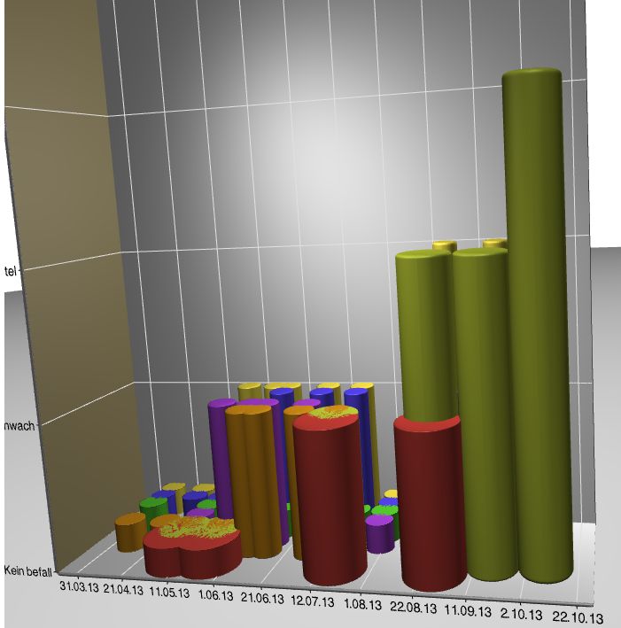

Post by nour sawas » Tue Apr 08, 2014 2:01 pm
It seems there is a bug when using datetime axis and bars. The bar sizes are not consistent. The problem exists with both 2d and 3d. The bars overlap in 2d mode.
I am using the version v1.5 of Teechart

Post by Yeray » Wed Apr 09, 2014 8:44 am
I'm trying to reproduce the problem with a simple 2D example but I'm afraid I can't.
