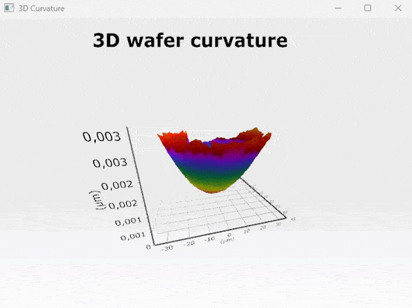

To demonstrate the performance I'm looking for, please find attached a project based on VCLTee I have assembled :
I believe FMXTee's Chart3D holds the answer to my question. It does seem to support hardware acceleration out of the box.
Unfortunately, within a Chart3D, trisurfaces don't render at all on my machine.
In the attachments, you'll find another project to illustrate this, here is its output on my machine :
Any idea what I might be missing ?

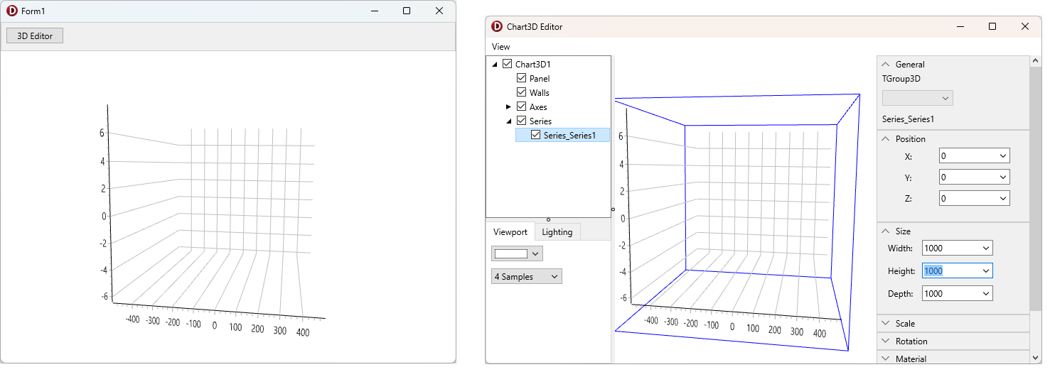

Have you been able to reproduce the TTriSurface absence of rendering within FMX Chart3D ?

The bug is about FMX TTriSurfaces not rendering within a chart3D. The relevant project is TriSurfaceInChart3D.zip :
Here’s a description and test plan for bug 2644 :
Description :
Within an FMX Chart3D, TTriSurface objects don't render.

Test plan :
1 - Unzip, build and launch the project in 64-bit release mode.
2 - Click the upper left side "3D editor" button.
3 - Within the newly opened window, select the Series group in the left side treeview.
4 - Make sure Series1 is listed while TTriSurface doesn’t render in the Chart3D.
Description :
Software configuration :
- Embarcadero Delphi 11.3 version 28.0.48361.3236.
- TeeChart FMX Pro with source : Build 2023.38.230607.
- Skia4Delphi version 5.0.0.
Hardware configuration :
- Intel Iris Xe graphics GPU (vPro i7 laptop CPU)
- Nvidia T550 Laptop GPUD
Test plan :
