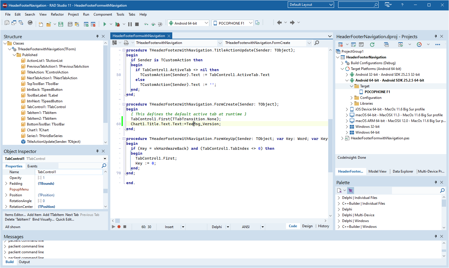

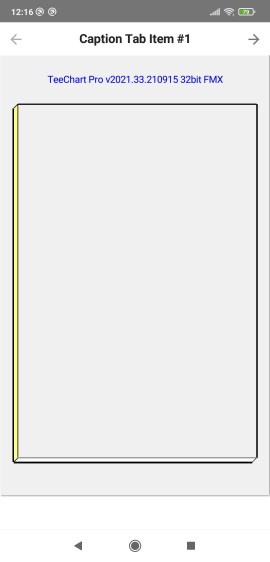

This seems to work fine for me here both with a Pocophone F1 and a Lenovo M10 tablet:
Note I've added the FMXTee.Constants unit and this code at the FormCreate, just to verify the version found by the compiler:

I have same verson in title, but this FMXTee.Constants have'nt solved my issue. I have also write to Embarcadero that such problem exist and they have also tested and found it. You can download full test project from one of my site link, its about 70mb because of Android and Android 64 folders. http://www.dialab.ee/tmp/Multi3.rar

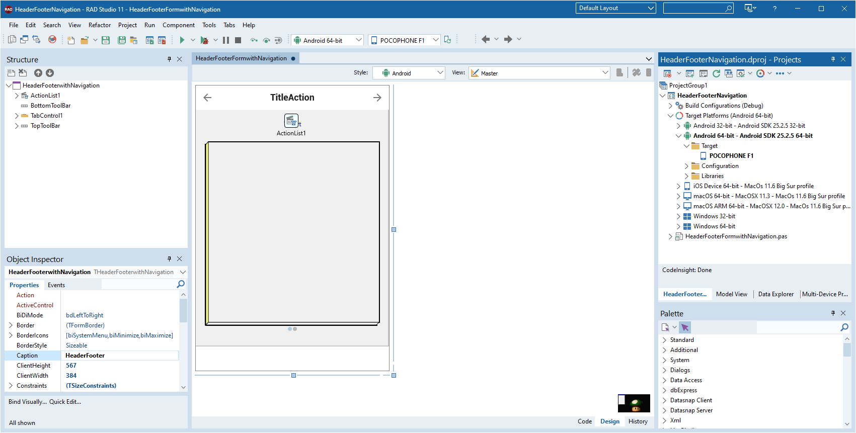

No issues for me here with your project:
