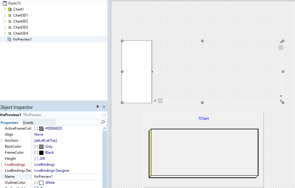

Sorry for the multiple posts. I wanted to let you know, Fast Reports Preview disappeared also. I am working with them too. So, it might be a Fast Report problem. I was able to put a preview on a new project, though it is not displaying properly. See the attachment.
